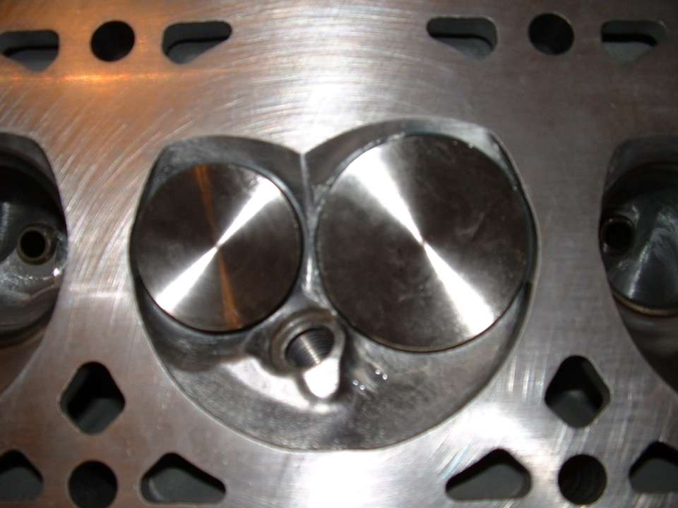

Here is a pictur of a 2.00" intake and 1.55" exhaust valve in a stock bore 5.3 head. Notice how close the valve is to the side of the chamber wall. This is how big your bore is on your engine. There is not a lot of room for air to get by there. If you open the chamber up more then you are making an area for air to collide on the side of the bore wall. Just think about it like this you have a 3.78" bore. Add the valve sizes up and you get 3.57" now subtract 3.57 from 3.78. That is .210 thousandths. Divide that by three. That is the approximate space you would have between the cylinder walls and between the valves themselves (equally). You end up with around .007 thousandths clearance with a 2.00" intake valve, 1.57" exhaust valve on a 3.78" bore. Get a feeler gauge and look at how much .007 thousandths is. There is a lot of shrouding going on there.

Wow, great picture Wess. I'm startin to see eye to eye with you now. Seems shrouding would really take affect with those size valves on such a small bore like we have. Am I wrong?
If some of you guys are lost by the word shrouding. Look at the pic. See how close the cylinder wall is to the outside edges (left and right) of the valves. This can limit airflow.
