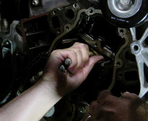

Work that manifold slacker..
or do you prefer this....or this....poor dog
