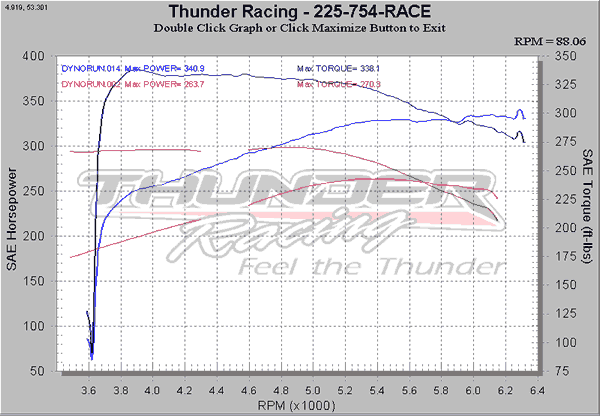

I haven't installed the TR220 yet. Its been sitting on my shelf since October. My plans for my truck have changed. Im going to buy a Procharger here in March and then go from there. As far as it goes for horsepower here the dyno graph of a 2002 with 5.3
Baseline (Before Camshaft) Dyno Modifications:
K&N FIPK, Thorley Headers, custom y-pipe with no cats, 3" exhaust with cutout, 3.73 gears, electric fans, Diablo programmer.
After Camshaft:
TR 220/220 .551/.551 112 camshaft, ASP pulley, Yank 3000 converter, Thunder Racing custom tuning.

That would be (Quickenuf)'s truck.
