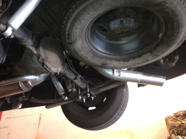

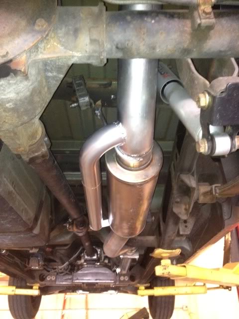

So KB did his thing, and welded the tailpipe back on after the underbed was notched. No clearance issues now. He also welded on a stainless 4" section of pipe that has a bit of a turndown at the end - nice touch and can be polished to a mirror finish when I get the time. The tip doesn't come all the way out, so it's got a subtle look - I like it. He also welded in a Helmholtz chamber behind the muffler which seems to have killed drone and lowered sound levels in the cab too. I was driving today and came to a stop on the highway and had to double check to make sure the motor was still running

Can you get a good pic under the bed. Wanna see how the notch and all turned out and with the new exhaust

Bump. Better pic under the bed of notch and new pipe over the axle?

I didn't get a good pic of the notch before we put the spare tire back up, but here is what I got.
