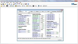

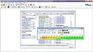

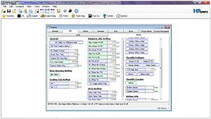

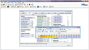

Originally Posted by smokeshow
Your calibration is untouched in almost all areas that deal with idle. The VE surface is also untouched, which gen 3 is particularly sensitive to at low speed. I hope you didn't pay much for this.
I pulled a 2004 4.8 auto from HP Tuners repository that is "supposedly" stock. I'm seeing the same on VE untouched but on the idle airflow a lot of the idle airflow adaptives are either different factory numbers or the tuner was monkeying with them. The base running idle airflow (BRAF) has been adjusted but my guess is to a "canned" number and not plotted against the idle airflow histogram in the scanner (because correct idle airflow config takes a good amount of time).
For those that are unfamiliar with HP Tuners... when you compare two different tune files, the tables that show green are different between the two tunes being compared.
Stock 4.8 Idle Airflow File
Op's Tuned File
Stock 4.8 Base Running Idle Airflow (BRAF)
Op's Base Running Idle Airflow (BRAF)
Don't forget these guys... GM idle stability requirements actually state that these calibrations alone should be capable of producing a stable idle, spark control disabled. They can also be used in tandem with the throttle follower (stock in the OPs cal) to produce a very sharp tip-in throttle response.
