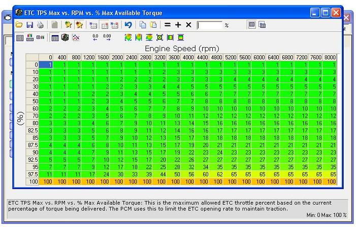

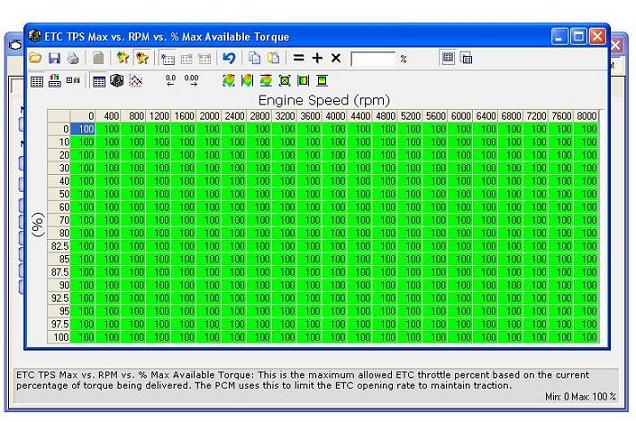

Originally Posted by ZZebes
DBW is "Drive By Wire" or ETC
NNBS is the slang affectionatley given to GMT-900 trucks
and the 06 Tac Module has a ramp rate built in to it that prevents the TB from snapping open. Basically if you floor it, the TB opens to something like 30% and then ramps in to 100% over like 3 seconds
not exactly, but here's what you're talkin about.
It's all fixed in a tune
Attached Thumbnails TB and Intake size?-stock.jpg   TB and Intake size?-edited.jpg
