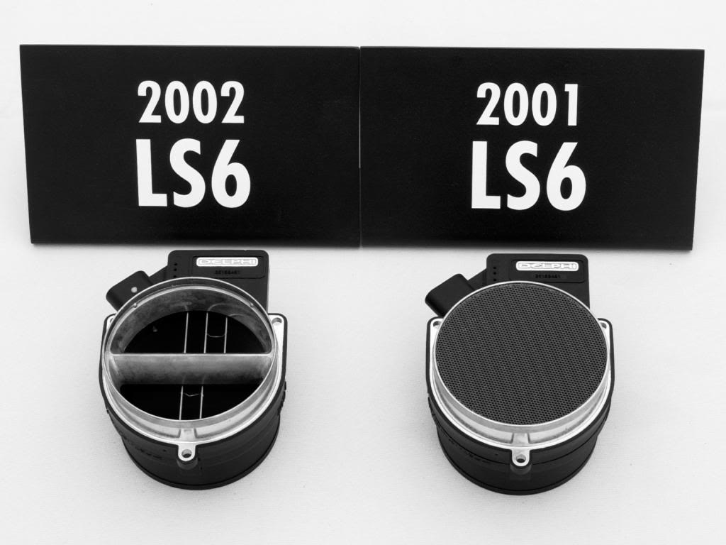

Old May 23, 2013 | 11:30 AM
hog's Avatar
hog
Joined: Oct 2005
Posts: 1,379
From: Woodstock Ontario Canada
Screened 01 LS6 and unscreened 02-04 LS6 OEM MAFs.
GM was able to do this on the Vettes because of its straight air intake tract. Not so much on the trucks
In the Vettes, GM engineers state that 2-3 hp was found swapping from the screened 75mm MAFs to the screened 85mm MAFs.
The screen no screen debate stems for the TPI Vette and Fbody cars whos MAFs were hugely restrictive. No so on teh modern vehicles.
peace
