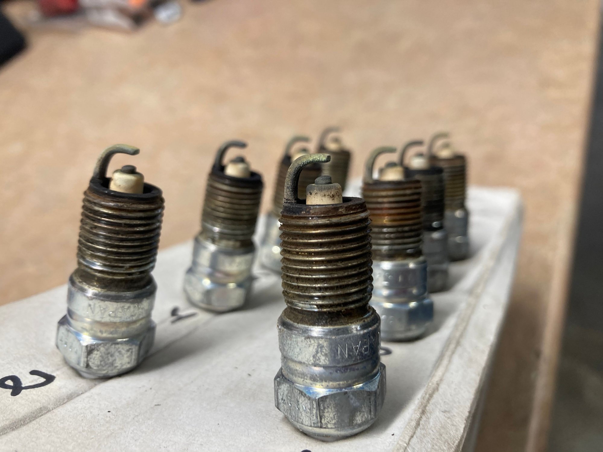

Originally Posted by arthursc2
heat damage or just wear?
wear. Bone stock 2500hd engine with a CAI.
