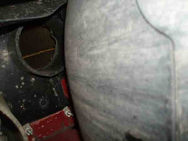

The tube is to dampen the intake sound. I put a 4.5" hole in the botttom of my box and cut the steel plate below it as well. Then I put a 4.5" tube down to pull the cold air. There is basically a built in heat shield under the plate. It pulls the air in right in front of the wheel well. Works great! I will take a pic and show you if you want.

Sorry for the delay, but here are the pics. Hope they come out, this is my first picpost

I did the almost exact same thing only I used the tube that was in the side of the box and epoxied it into the hole I made on the bottom of the box! Did not know anyone else out there tried this! Don't know if it helps, but can't hurt--kinda homemade cold air kit.

thats what mine looks like, but it has the volant ram air kit coming up through the hole
