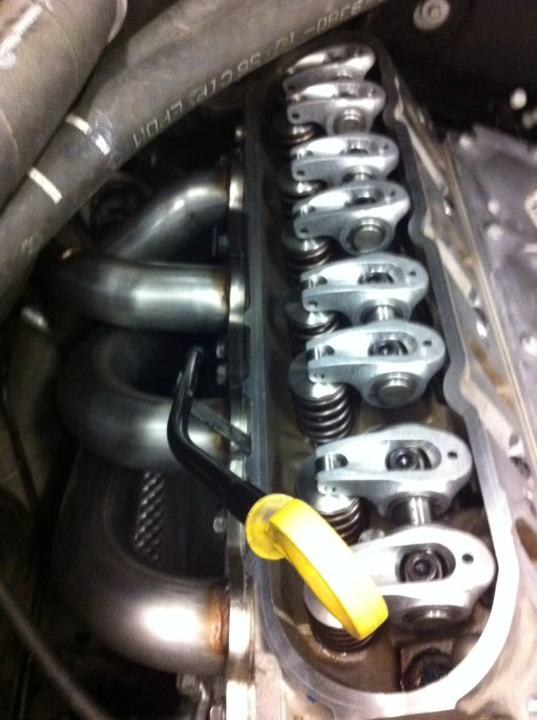

Finally got the tracking number, and the headers should be here friday. Hoping to install them Saturday. Will i be fine re-using my stock manifold gaskets? Keep in mind the truck has a little less than 5000 miles.
Old Jun 6, 2014 | 06:07 PM
TAPyvehc93's Avatar
Joined: Aug 2013
Posts: 379
From: Mooresville NC
YES!!! Finally they are here. I will be installing them tomorrow. Hopefully everything goes smooth. Can i use the gaskets that came from american racing or should i re-use the stock ones? Also, whats the torque spec for the manifold bolts?
Old Jun 7, 2014 | 12:20 AM
jgreen-fsi's Avatar
Joined: Jun 2013
Posts: 34
From: West Texas
I would reuse the stock ones. The GM gaskets are much better. 18 foot pounds I think. I would do two passes. First like 10 or so starting from the middle and working out.
