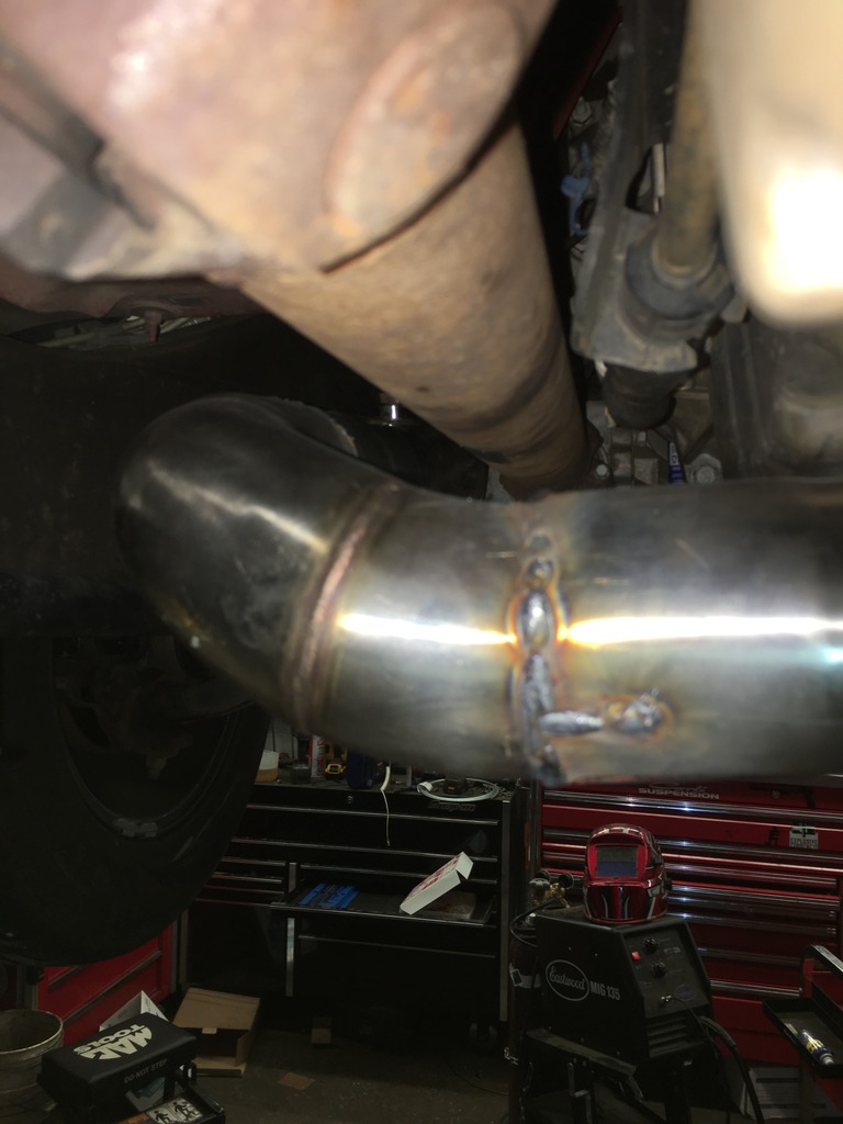

mine nailed the driveshaft in my truck, had to modify it. Used the extra piece they include for 07+ trucks. Pics below.
I've said it before and I will say it again. Even if the motor mounts were collapsed, replacing them would make this fitment worse because it would raise the motor up, thus raising the y-pipe into the driveline even more. These y-pipe's are simply poorly quality controlled. Sean from SE disagrees with me and offered no replacement.

I just installed my speed engineering 1 7/8" long tubes on my 03 5.3 with a 4l80e swap. I had to dent the y-pipe in 1 spot below the trans pan and 1 little spot on a primary on driver side by the frame. Other than that, they fit perfect.
