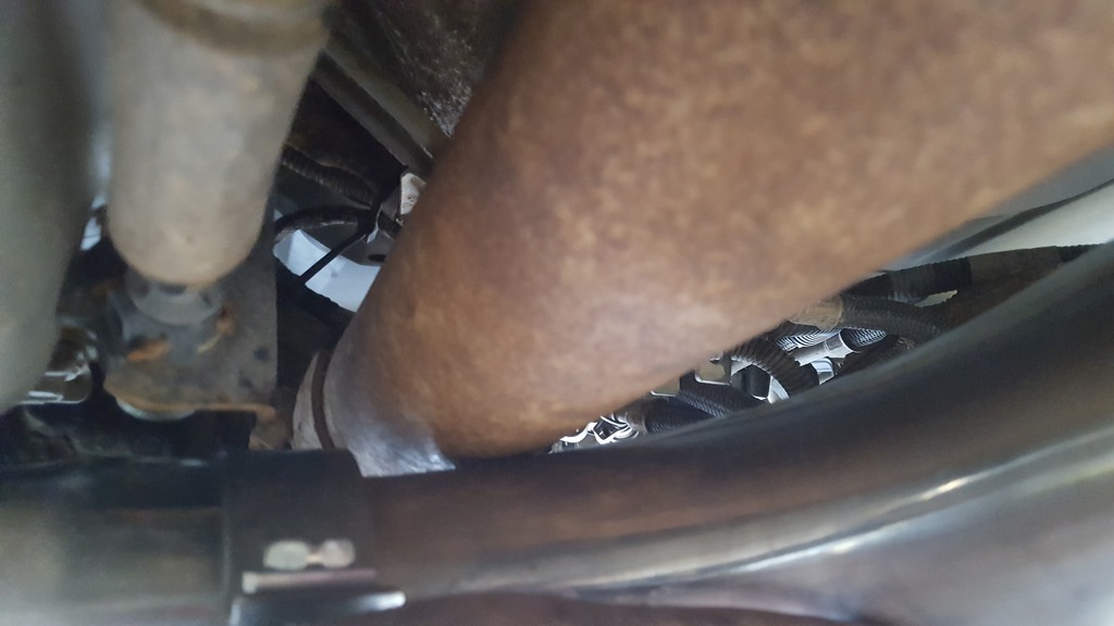

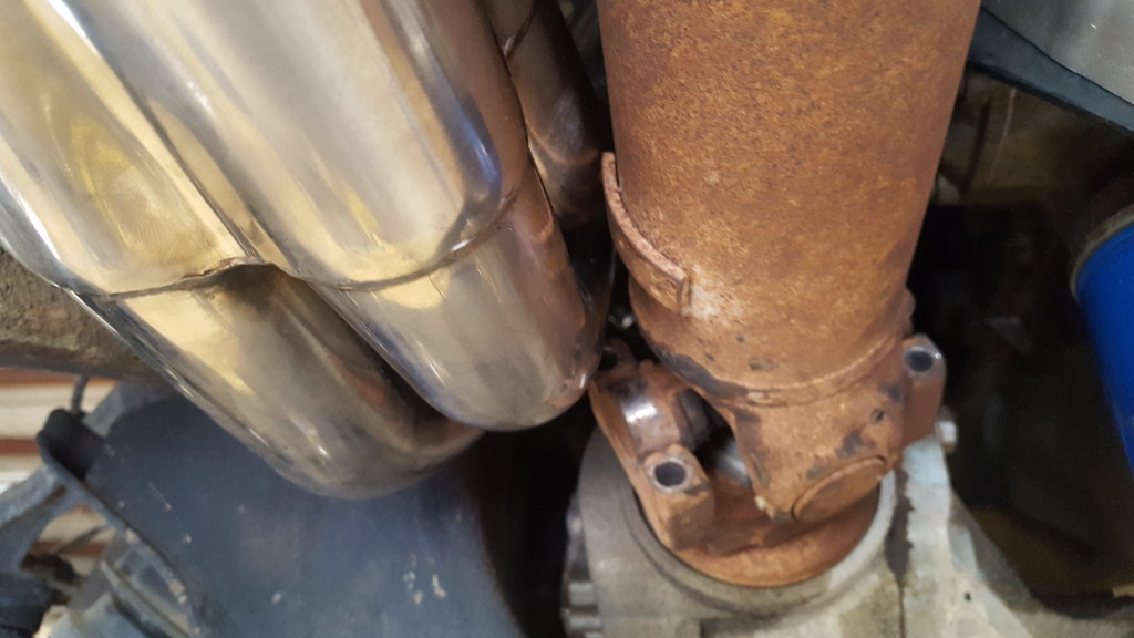

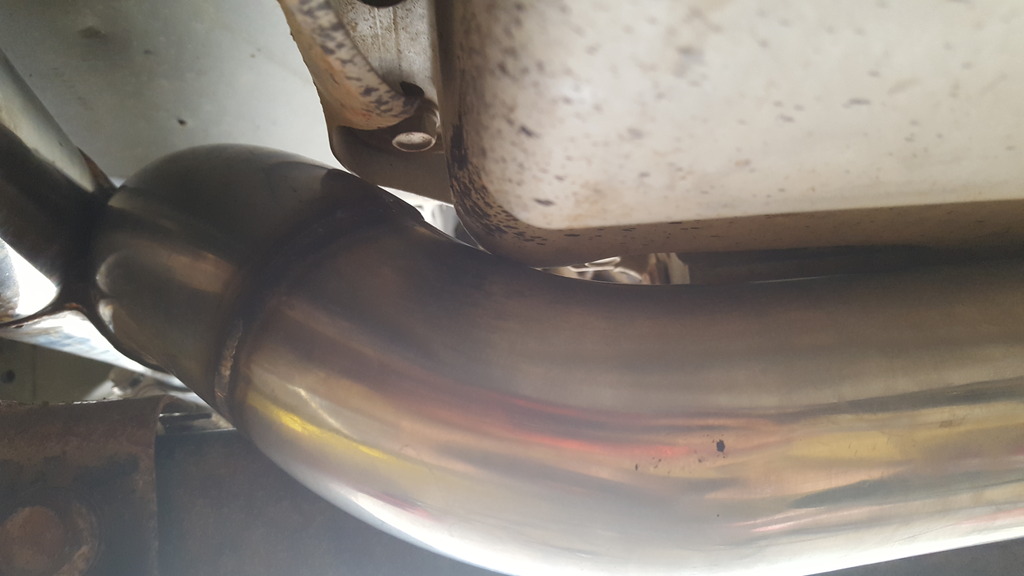

Originally Posted by Mrice
Did you replace your motor mounts?
Yes, brand new motor mounts, the driverside header is hitting the bolt heads for the yoke for the front differential, and the y pipe is hitting the driveshaft. There is less than an 1/8" clearance between the y and the transmission pan on the pass side.
All in all, I think if you have a 2wd you could run them...

Old Sep 18, 2016 | 08:05 PM
Formula96's Avatar
Joined: Feb 2003
Posts: 694
From: Longview, TX
Originally Posted by Ray Finkle
Wtf!? They advertise as fitting 2wd and 4wd. I just bought some last week but have yet to install them. I will lose it if they don't fit.
Old Sep 18, 2016 | 08:10 PM
Formula96's Avatar
Joined: Feb 2003
Posts: 694
From: Longview, TX
That's clearance with a hammer and still rubbing.
There is some space here but not much...
