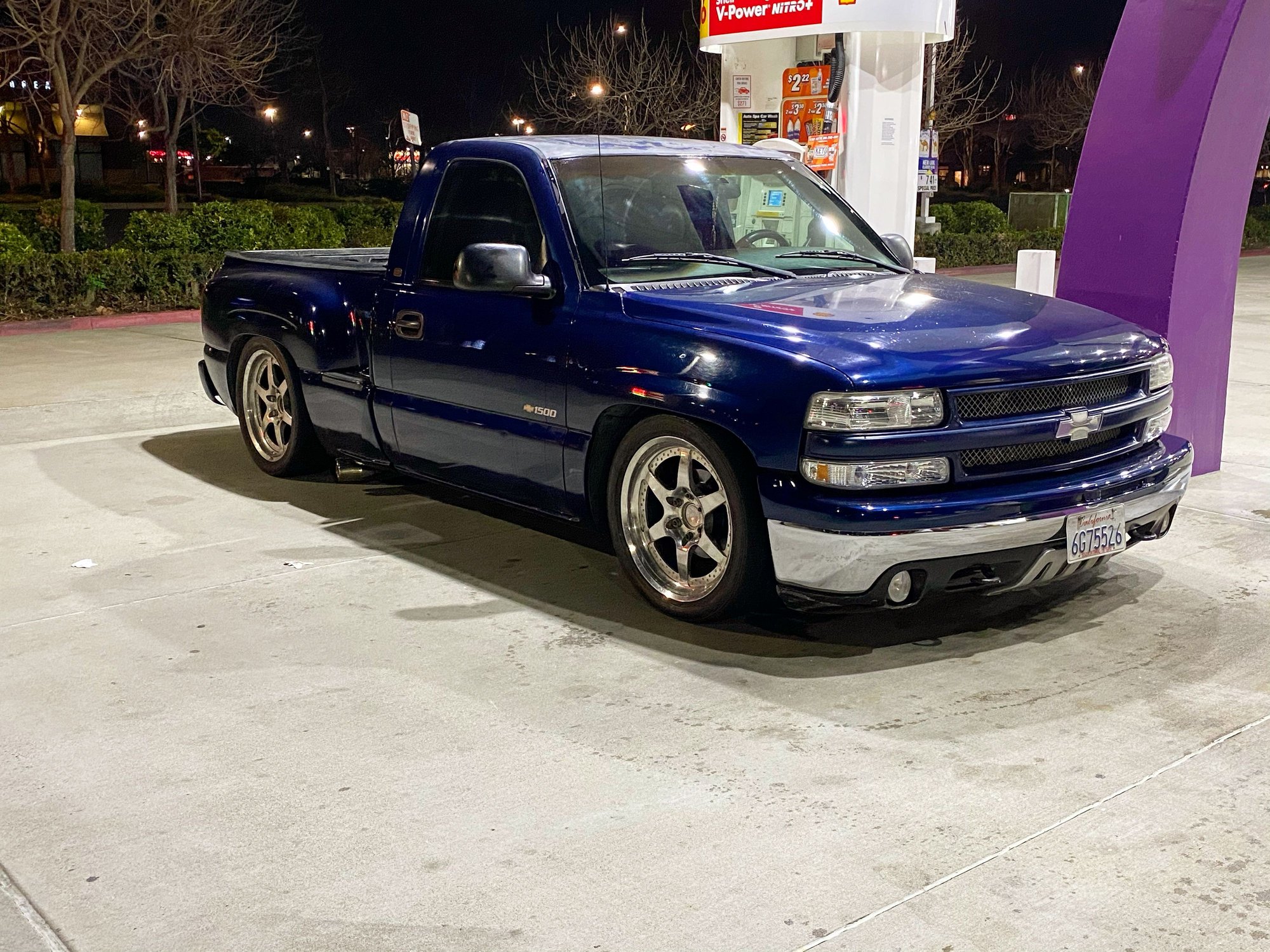

Pic for attention:
Hey guys, I’m looking for input/info/experience from the California guys on here regarding smog. So truck finally has a stage 1 4l80e I swapped into over winter break. So time to focus on adding some power in the mean time so I don’t get entirely bored and keep the motivation going. Truck is a 2000, 4.8, 4L80e, 3.73 10 bolt (will be swapping a true 9.5 14 bolt since I need a new driveshaft before I run it on the dyno anyway), no shorter gears tho as it already runs about 2400rpm @ 70. It does have EGR and AIR injection which I plan to keep functioning until I swap in a fully built engine, would rather avoid blowing $3-400 hot smogging a little 4.8 lmao. Truck has shorties and a “Cold air intake” and currently passes fine (without the catch can anyway).
Before I start, yes I know the usual spiel, “don’t bother with the 4.8 unless you’re doing FI” etc etc. I already have a few parts for a stroker build later on when money isn’t as tight. With that out of the way, I already have a TBSS manifold (with the blocked off EGR provision), ported 92mm WARR throttle body, 243s I plan to mill .020 and gain the rest of the compression back using thinner (Cometic) head gaskets, Trick Flow/Jegs/Elgin 216/220 .560/.560 @114 and 36lb flex fuel injectors. I figure basically everything (minus the throttle body which I think I can...disguise) should go through any smog place fine. If push comes to shove, I’ll try to source some of the Vortec 6000 3 piece engine covers and that should cover just about everything lol.
TLDR: Do TBSS intakes pass smog visually?
