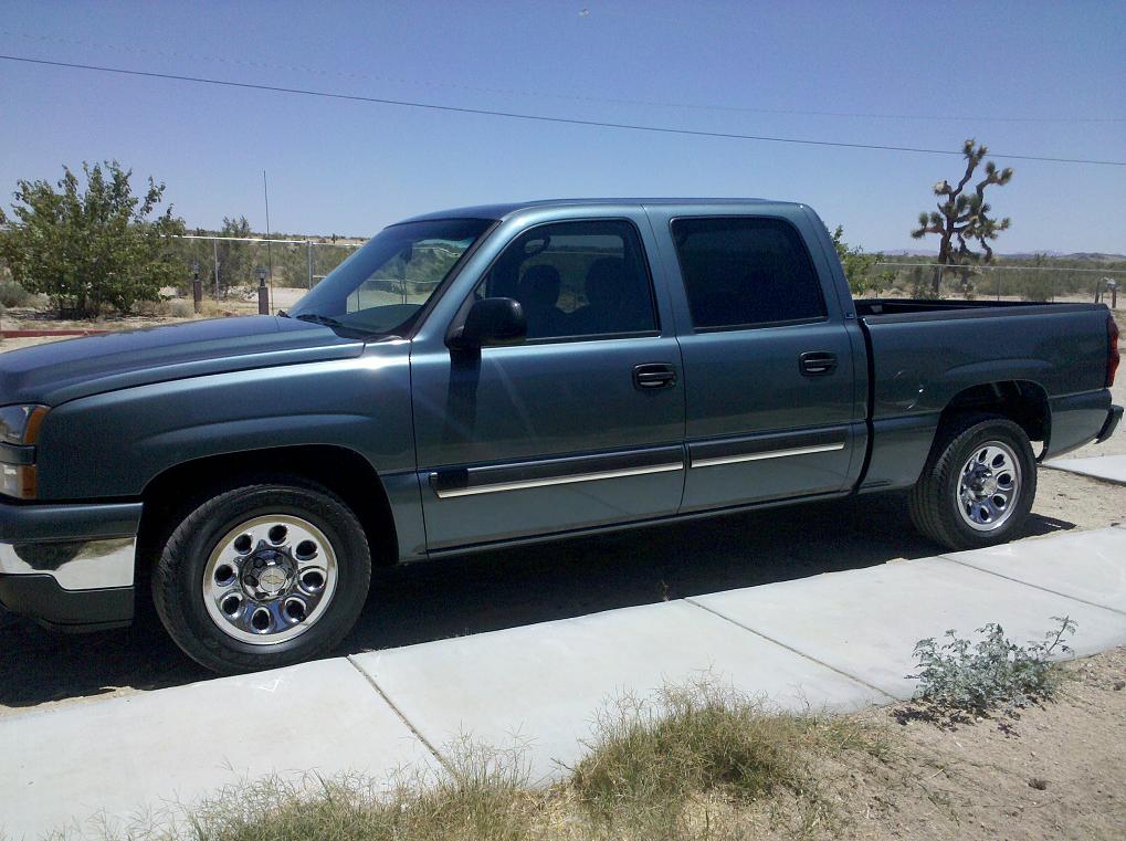

I obviously have a few posts over on LS1Tech and have been driving a Camaro since June of 1995 but I need help. Since knowing my wife she has had a '95 Jeep Grand Cherokee Limited and then a '04 Ford Exploder XLT. I just bought my wife her first Chevy and we got her a '06 Silverado with the 4.8L. My questions are what is the name of the engine itself, LQ _ ? Also what type of cat-back is best with these or is it the same as the F-body world in performance gains by manufacturer? CAI preferences? This is not a keeper truck for us for more than two or three years for us we figure. Simple bolt ons with nice relative gains in both power and gas consumption are really what is being looked at. Thanks for any help.
