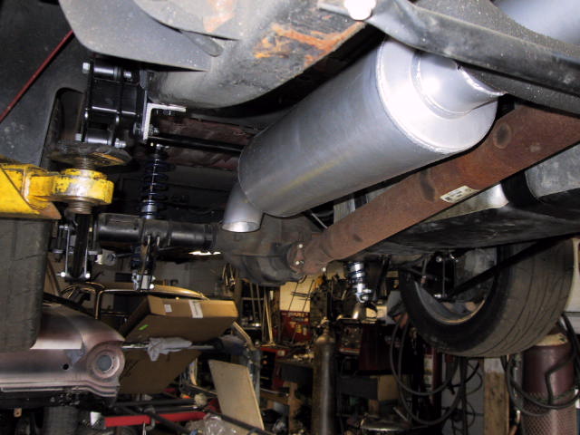

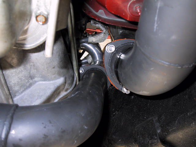

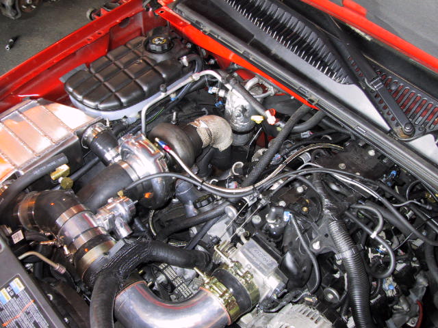

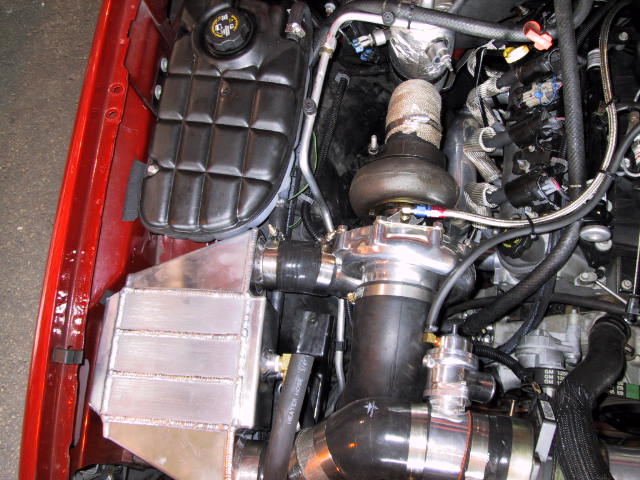

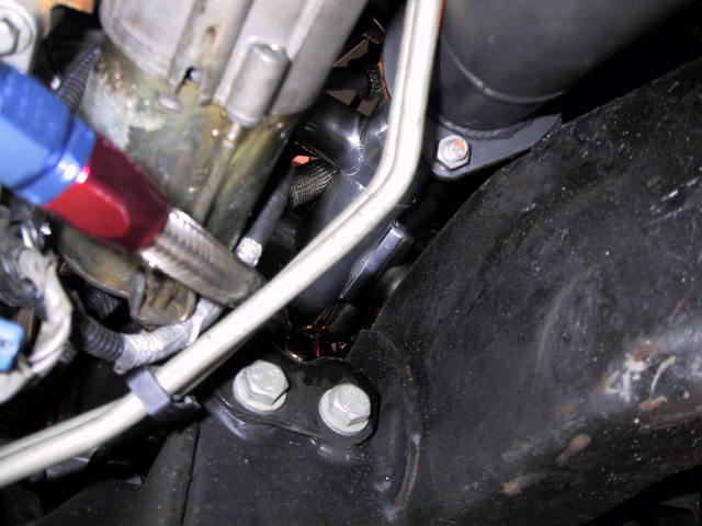

Well yesterday I finished all the rest of the little things ,wired the fuel pump boost controller and topped up all the fluids and clean things up and finished the exhaust up
7pm rolls around after starting at 8am Flashed it with a new program from Seth from Combonation
Turned the key and made sure the fuel pressure was there and it was
Turned the key and she fired right up no Problems and Proceeded to idle nice and smooth didn't hunt for idle just perfect
The Exahust is a 3" downpipe off the turbo into a 3"-4" adpator into my 4" main exhaust I have a big diesal muffler there with a turndown in front of the rear axle
This setup sounds freaking awesome nice and deep
We noticed I had a pretty bad leak at the v-band clamp at the turbo
it was a temp replacement that i was hoping was going to work .they forgot to ship me one..
The Cam idles nice being a 232 230 596 591 113las +2degrees ground in
All in all I'm very happy it was long week of install
I had to Deal with some fitment issues and buy a few things to make the kit work
Now I just need that V band Clamp to go for a spin
here are some almost finished pictures
Attached Thumbnails She's ALIVE the Big Bad Turbo monster Cometh !!-img_0075.jpg   She's ALIVE the Big Bad Turbo monster Cometh !!-img_0077.jpg   She's ALIVE the Big Bad Turbo monster Cometh !!-img_0092.jpg   She's ALIVE the Big Bad Turbo monster Cometh !!-img_0096.jpg   She's ALIVE the Big Bad Turbo monster Cometh !!-img_0104.jpg

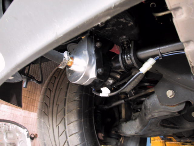

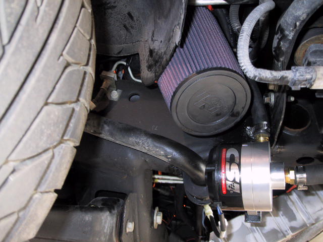

Some more pictures
Attached Thumbnails She's ALIVE the Big Bad Turbo monster Cometh !!-img_0107.jpg   She's ALIVE the Big Bad Turbo monster Cometh !!-img_0108.jpg   She's ALIVE the Big Bad Turbo monster Cometh !!-img_0086.jpg   She's ALIVE the Big Bad Turbo monster Cometh !!-img_0082.jpg

Cool stuff Jim. What kind of water pump is that for the intercooler? Do you know how many gal/min it flows?
Thanks man.
Ryan
Old May 14, 2004 | 05:38 PM
GMC SKI's Avatar
Joined: Mar 2002
Posts: 1,452
From: toronto
The pump is a CSI race pump pretty hard hardcore unit
I'm not sure of the flow numbers but i think it could empty a pool in 20 mins
When it turns on it moves on the metal mount to the frame

Love it, can't wait to see some time slips and surprised looks from us hemi guys! Also, I like how they used the stock air box location for the intercooler. Awesome engineering and quality there!
