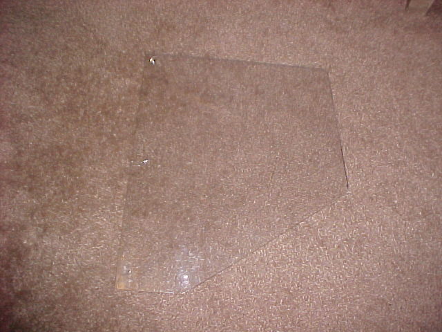

I took a clear peice of poly carbonite so it would fit on the top of the airbox resting on the fender and radiator support. I used the bump stop bolt and fender bolt along with the small screws to hold it down,. I had to use the poly because it was the only clear plastic like material that wouldn't crack when bent. Any glass shop should stock it. Use a thin piece of poster board as a template.
I had to do this because a HD hood on a 1/2 ton doesn't seal.
I didn't notice any increase in power but I don't have any way to verify but the track.
I don't know if you can see it on my cardomain
