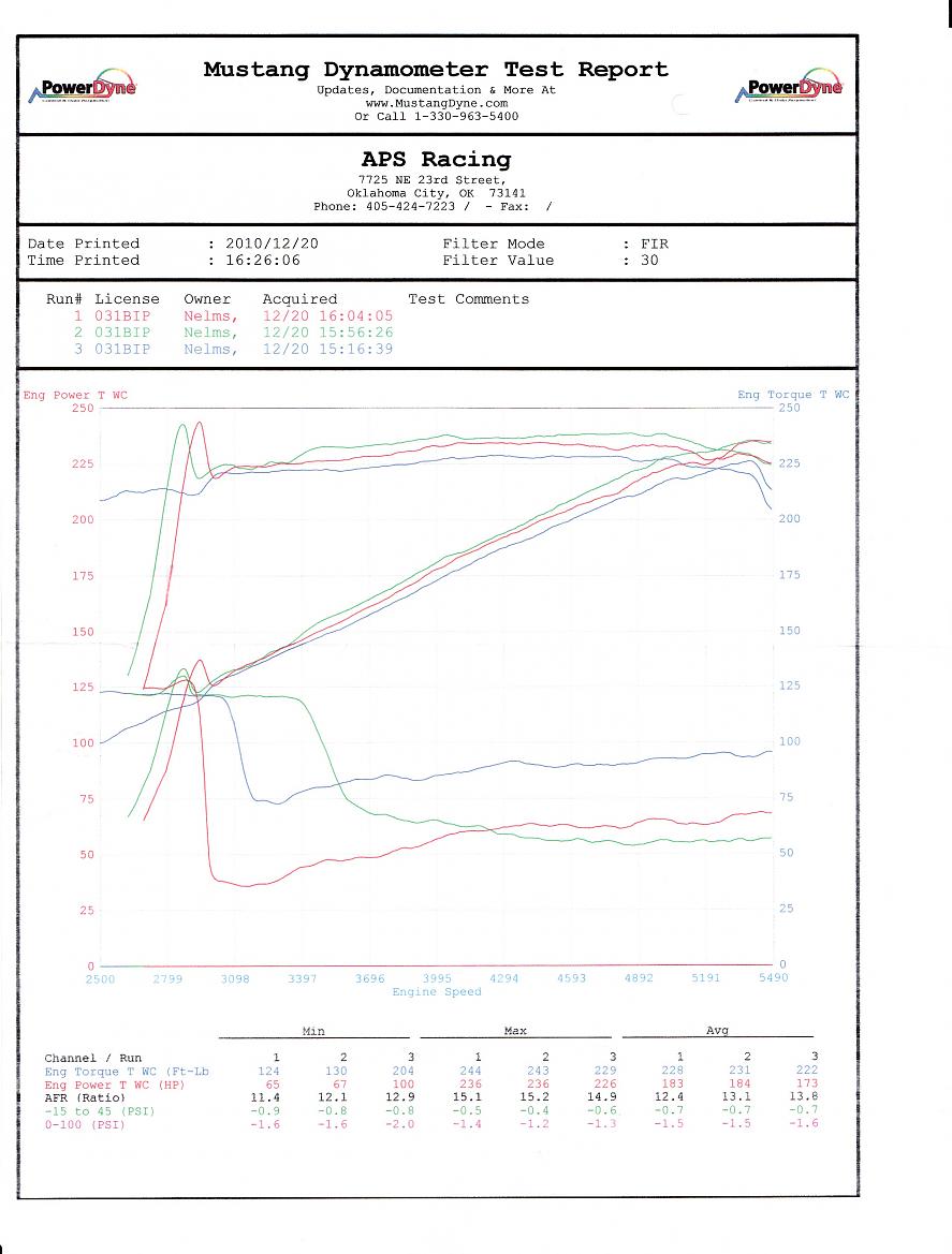

Here's a dyno of a 4.8 5spd, CAI, shorties, exhaust. 1st run was a stock tune on a dirty MAF, second run was a stock tune on a cleaned MAF, third run was my 2 months experience with HPT taken from a truck with a dirty MAF.
