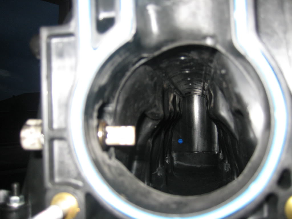

I relocated mine to the EGR spot on the intake. I just ran it at the track and my IATs started at 122 at the end of the run it was 99.. I was rougly 96* outside today... I ran a 8.5 today so 122-99, in 8.5 seconds...

Originally Posted by JoeGibbSilverado
need pics, if u benefit, im up to it,
EGR block off plate that came with my Dorman Intake
IAT sensor location
