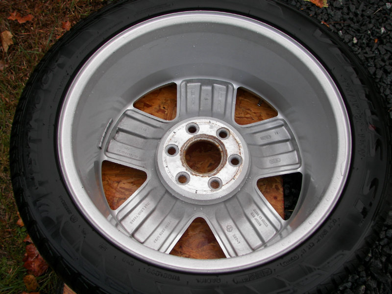

I can't get over how sick that photo looks, maybe I am weird tho
Everyone knows I'm the resident "photo *****"...
like the old saying "a picture is worth a million words"
I'm more impressed your wheel barrels are clean! The amateur and weekend warrior detailer always forget to address the inner wheels. Your wheels have big enough openings where you can fist a wash mitt through to clean... no special brushes or wheel woollies needed
Photo ***** Warning!
During tire rotation is the perfect time to do a thorough cleaning of the barrels
