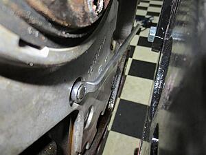

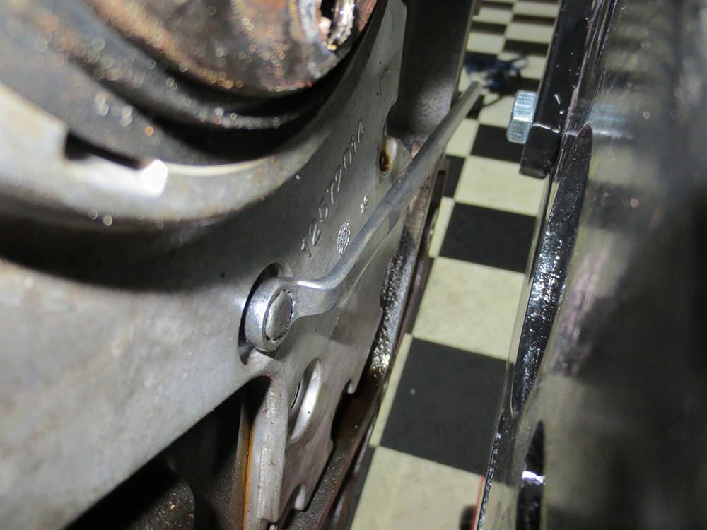

Rear main install
That's good you got the orientation correct should be good to go.
The LS rear seal is a good design much better than the old first Gen small block. That seal was a two piece design that was prone to leak. You had to dab RTV between the halves and cross your fingers. The early 283 and 327 SBC's had a rope rear seal and they were a nightmare lol
Rope Seal
Rope Seal
Oh god that does sound awful
Yeah I saw some oil running down on the back of the rear main cover so I think I got the oil leak. Cross my nuts hope to die that it is. I think I did well on the install, hardest part was having about 6 inches of clearance to wiggle my ratchet and about 8 inches from chest to oil pan. Tight fit lol
I remembered that odd rascal
I’ll take a pic of my setup today lol
my girlfriend says no working on it today because I have concrete burn on my back. She is going to the movies so that means work on it for two hours
