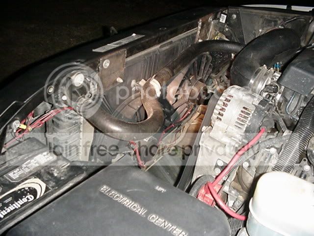

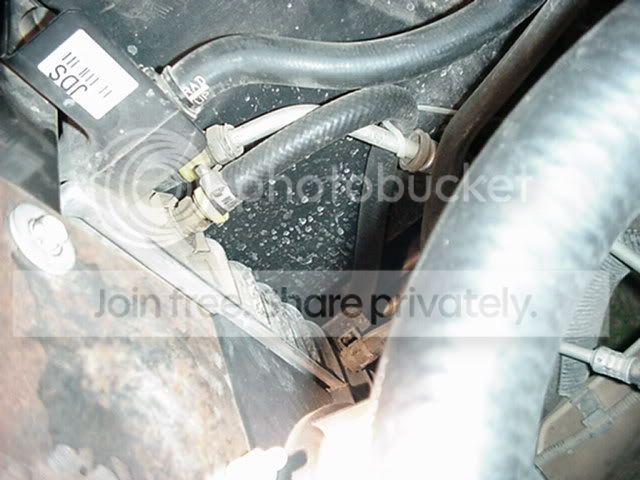

Here is a accidental picture of the passenger side one.. i just cut some 1/8" metal and put a slight bend at the top 3/4" of it so it actually presses the E-Fans up against the radiator, i put some thick weatherstripping behind mine to keep from rubbing the radiator..

them are for my stock 28" radiator... for my buddy the brackets look similar except longer and sharper bend at the top. it has a good bit of space on each side of mine as you can see. and on his its a little more, but he has no cooling issues at all. I tow alot with mine and i have no issues either..
