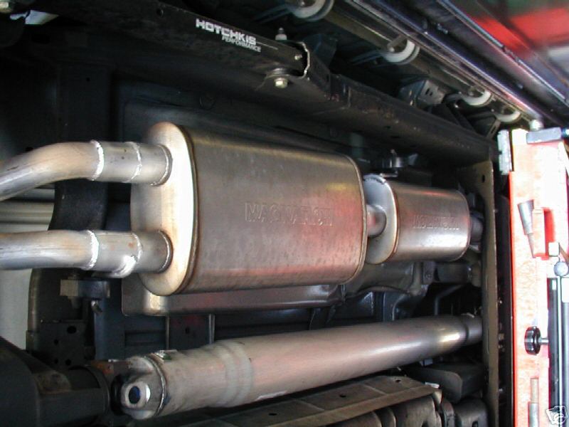

I installed two Magnaflows, one in front of the other. Cost me about $150 for the mufflers (easy to find a good price online for Magnaflows) and another $75 for welding. I had a lot of room, you won't have as much with a RCSB, but the cool thing about the Magnaflows is that they come in so many sizes that you can tailor the mufflers for your vehicle.
Tip #1 - Get 5 x 8 ovals over the 4 x 9 ovals...that extra 1" in height makes a bigger difference in sound reduction, more so than the extra 1" in width does.
Tip #2 - If you can afford to have two tailpipes bent, get a single-in dual-out muffler (5 x 11), which will further dampen sound.
See the attached pic, which shows my setup:

Nice. I dont have that much room though. I really just wanted one tailpipe, and want to keep my cutout. I was planning on welding the cutout right at the collector, to a bullet, then to the Magnaflow then running a tailpipe out BEHIND the rear tire. BTW two 3" tailpipes would be $$$$
If you replace the bullet with a short 5 x 8 Magnaflow, I think that would help considerably. The come as small as 14" in length.
If you want to go further, that 4 x 9 Magnaflow is not the best as far as quiet is concerned for a main muffler, 5 x 11 is best. They come in single-in, single-out.
