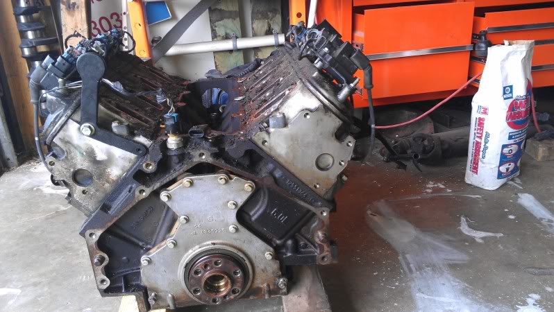

so i picked up the motor today and it turns out it's a lq4. wonder what caused the rod to break where it did...about an inch from the big end. what kind of hp are stock lq4 rods designed for? thinking about doing a forged bottom end for a future turbo i just need to figure out my budget for this build. thinking 450 to 500 hp n/a and don't know where i want to be when i go turbo.

btw this will be my dd so if those numbers aren't reasonable and still keep decent highway mileage then i'll tone it down abit. i'd also like more torque down low for when i have to tow something. i really don't want it to be like my '03 3/4 ton 4x4 that got 11.72 mpg. 16 on the highway would be acceptable but 20 would be awesome

I dont know if you will get 20 out of a 6.0. I have a LQ4 in my 1/2 ton and my aero force is showing avg mileage of 18.3. Doubt thats right though. Im thinking more like 16.
