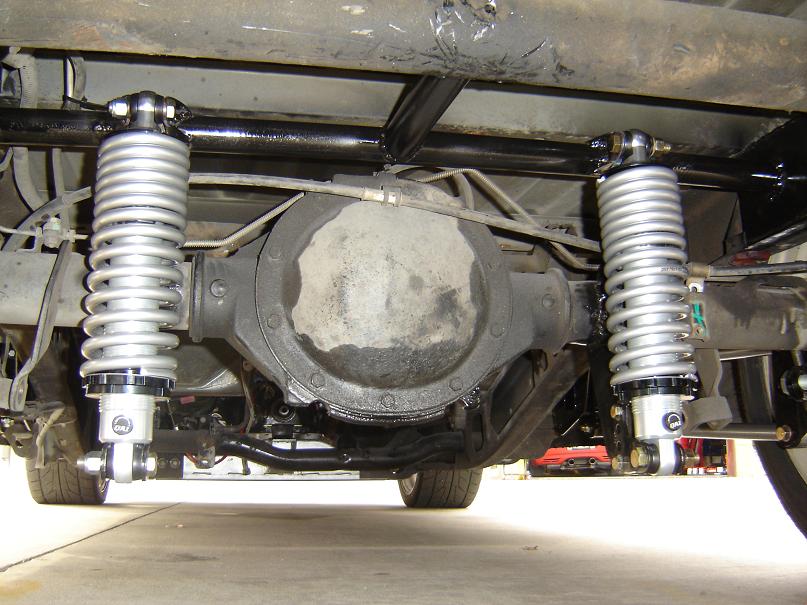

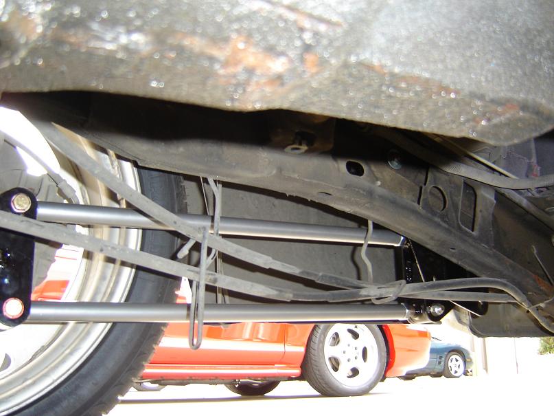

So we have been working on it as much as we can. So far the motor, tranny, shifter, 4-link, coil overs are in. All that is left is the brackets for the blower, which I will get back today, drive shaft, which is ordered from APE, wire up the fast, and the finish the fuel system. The 4 link turned out great, I am going to take pictures of it right now. Whoever wants to host them then PM me and we will get them up here for you picture freaks.

Would you mind giving any details real quick on the 4-link?
No welding or difficulties?

I think I might have figured this out let me try. Let me know if you get the pics.

Looking good man.
So you do have to weld the mounting brakets for the coil overs onto the axle and link.

sure do

Hey Ryan,
What did you weld the front 4-link bar to? I've seen some weld in a cross-member and attach the ladder bar or 4-link to that, but couldn't see in the pic.
I should be down there this weekend, hopefully I'll get by and see the shop.

We welded plates to the frame and welded a peice of roll bar tubbing to it, then welded tabs onto that for the coil overs.

2tone- is that a inhouse made 4-link or is it a bought kit???? either way it looks kick ***
