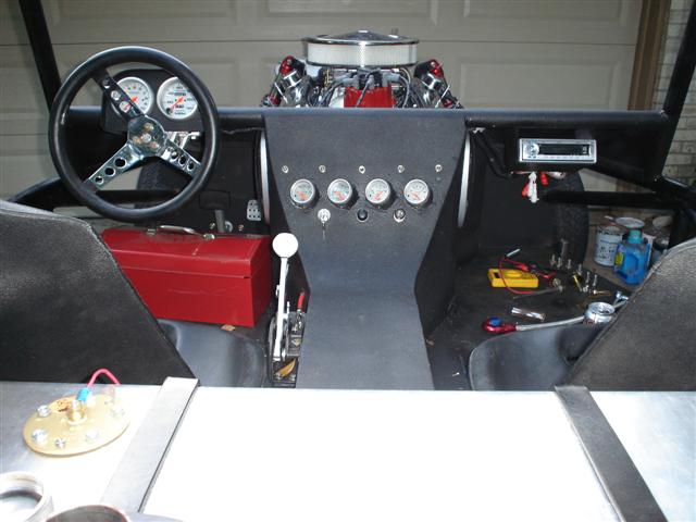

what kind of 383? GenI/GenII/GenIII, GM Heads? partnumber on the heads? Headers on my dune buggy are hooker long tubes and they take on a sort of oval port from the primary, but on the 882 heads it's an oval type port, i'll post pix if I can find em...
editing: found some pix of the headers on the motor.
hope the pictures help you kinda. the link is to a video with the motor in it.
and on the model number of the heads I'm pretty positive they're 882 it's written down here somewhere, anyways I hope I helped some.
http://s88455272.onlinehome.us/buggy.wmv
Attached Thumbnails Problem w/ headers...-buggy-130-small-.jpg   Problem w/ headers...-buggy-139-small-.jpg   Problem w/ headers...-buggy-183-small-.jpg   Problem w/ headers...-buggy-185-small-.jpg

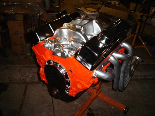

very nice. now i know what mine will look like with polished headers and chrome valve covers
here's the headers...

the pic of the headers you posted look like they're really polished chrome or ceramic coated. stick a magnet next to it and see if it sticks. if it does they're not stainless.
