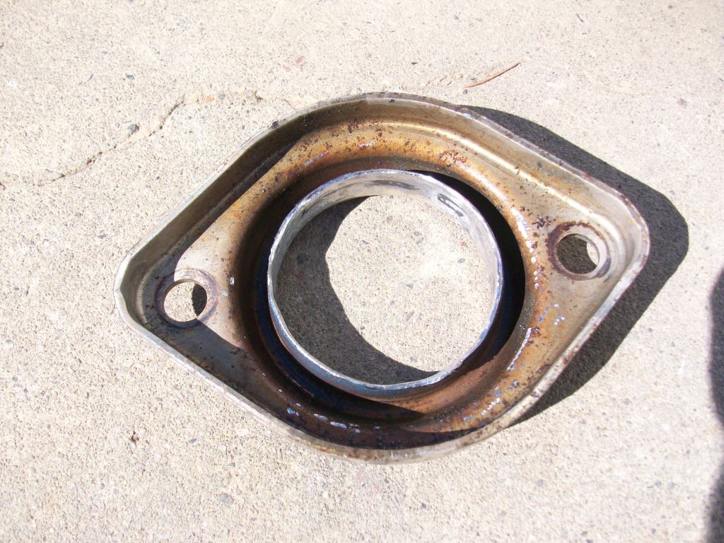

Yeah. I got an exhaust from a eclb I was told. it still had the muffler, but was cut before the cat.
The picture above is my final setup before I put it back under the truck. the piece to attach to the y is actually the tail pipe piece (the one that pokes out behind the tire), with the proper angle cut into it to fit the y. Then I also plasma cut out the original pipe from the flange to make it a little larger inside. Then cleaned up with a die grinder to make it smooth inside.

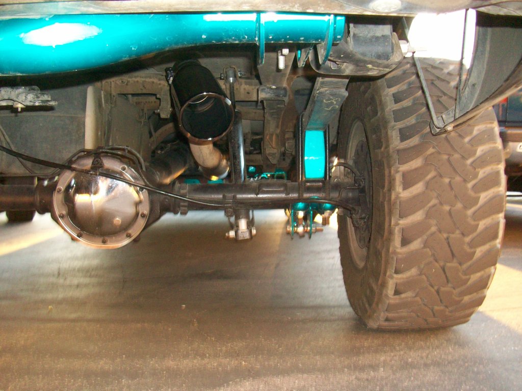

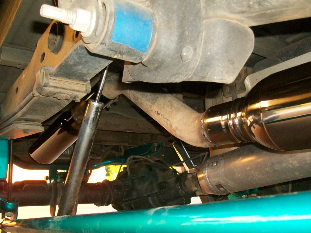

Welded the straight section to the curved piece that's designed to go around the frame crossmember, the hanger on that curved piece is the same between the hd and half ton frame fyi. welded my muffler in at the end of the curved piece, and then the other piece pf the tail pipe upside down to make it go over the axle.
and how it exits. my tip is a little higher than I like it to be, making it sound quiter since the sound doesn't bounce off the pavement.
