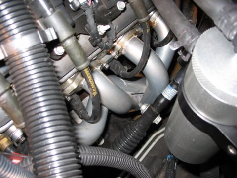

All these wires will work with any header. It's just that the MSD's have better boots on them than the Taylors. I prefer Taylors's but can't run them due to one of the boot's being to fat and over time burning up on the header. I'll see if I can find that picture.
Old Feb 7, 2005 | 09:56 AM
GREGGO's Avatar
Joined: Dec 2001
Posts: 9,101
From: League City, Texas
Here you go. This boot was close to the header and got very brittle due to heat. That's why it cracked. They also had about 35k on them running next to the header. Taylor 8mm

yay but the asm,'s are fatter on the tubes than the jba's are. im going to try some msd's soon. i have gone thru my second set of taylors now. each set has had one go bad.here is a pic. but not very close. it is cylinders 3 and 4 that are real close.

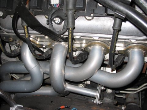

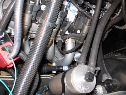

I'll try thses pics again,
I'll have to keep an eye on the Taylors;

yay i kept feeling a wierd miss. i started by looking at the plugs. then started ohming out the wires. 28ohms for all except one that went to 200ohms. and yes the round type coils allow toy to use the vette and camaro wires which are shorter.

my stockers are on except on those two cylinders. 3 and 4. the stock wires hit the header and cause it to melt the boot. maybe mine are a little different. but they do hit. im going to get a set of msd's tomorrow and see if they work.
