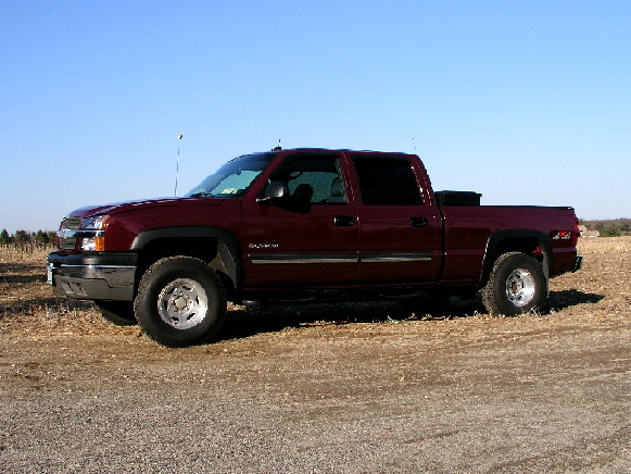

i own an 03 1500hd ccsb with a 6.0 . i did a few mods that really made the truck wake up because the thing weighs around 6800lbs.i'm not into going into the motor,i'll leave that to you young guys.what i did was a tbs,drop in kn,gms maf sen.,edlelbrock headers and the ppg111,87 oct.i retained the stock muffler.if your uncle has an ecsb he should do quite well. as they are around 1400 lbs lighter. here are some pics of my trucks.

nice truck man. thanks for the help. what is a tbs? and what is a ppg111,87 oct?
