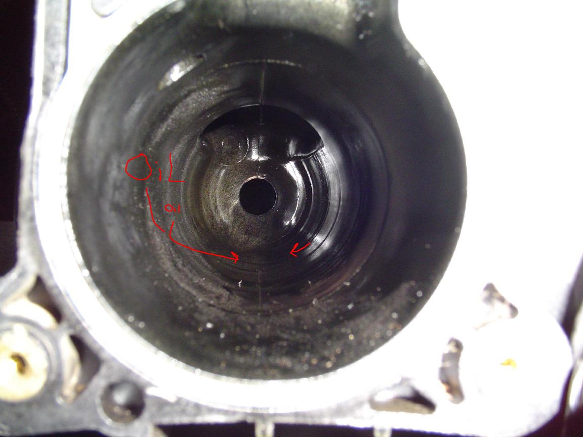

well,, as you guys all know, nubers 2 and 7 are missfiring on my truck, and today, i took off the aux injectors so i could look in my intake manifold.. and there is oil seeming to be everywhere inside,,, not puddled, but all over the top and kinda drippy in the corners. any thoughts on this? also there is a small plactic hose attacted to the top of the intake right behind the opening of the intake, i noticed the other day that i could hear it making a ticking sound. i never noticed it till about a month ago

i took a flashlight and looked into the intake manifold today,,, and low and behold, a big puddle of oil all the way in the back. can anyone tell me, is the pcv the pipe all the way on top of the inlet of the manifold?

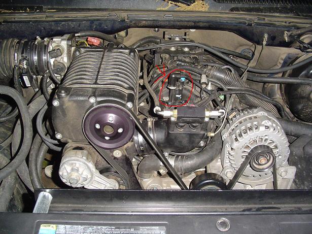

well,, then this is not were i think the oil might be coming from then, here are a couple pics
first is of the inside of the intake, the other is the where i think the problem might be coming from. i pulled the hose off the top of where the pcv valve hose hooks into the manifold,, it was bone dry.
