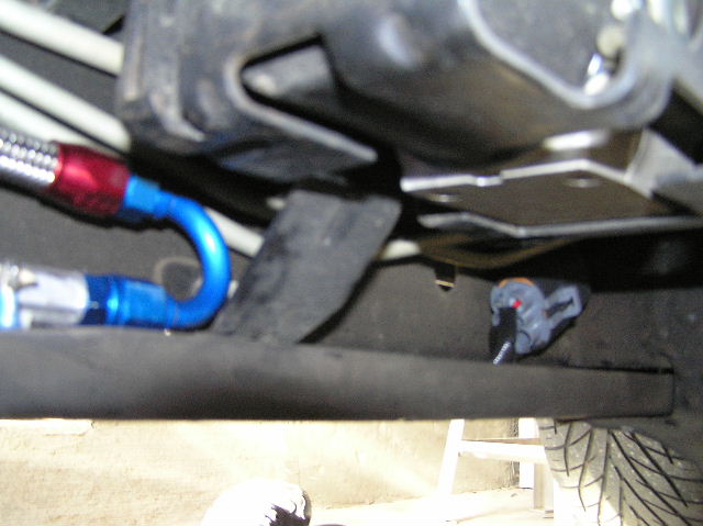

Did not want to cut OEM fuel lines or use rubber hoses and clamps. It was a pain in the *** to find all the thread sizes. Making the SS hoses was very easy with the Earl SS hose and fittings. It didn't increase my fuel pressure as much as I thought.
mounted the pump in 2 existing holes in the frame. Only had to drill one hole to hold the relay.I also used the Nelson wiring harness
Before walbro
in park 42
cruise @55mph 45
wide open 47
After walbro
in park 45
cruise @ 55mph 48
wide open 50
I though some people on here said they were getting 55 to 58 at wide open with the Walbro in-line.

Man you are my savior!!
I have been looking for these fitting for way too long! I really did not want to do the push on fittings either. I even went to two actual speed shops in our area and no-one knew what fittings would work. Thanks allot for posting this up. Where can I send your free 12pack of beer to??
Nice install dude!!

Thanks for the beer offer. That what this site is for to me.
I noticed in the part # picture that it cut of some of the quanity of each off.
