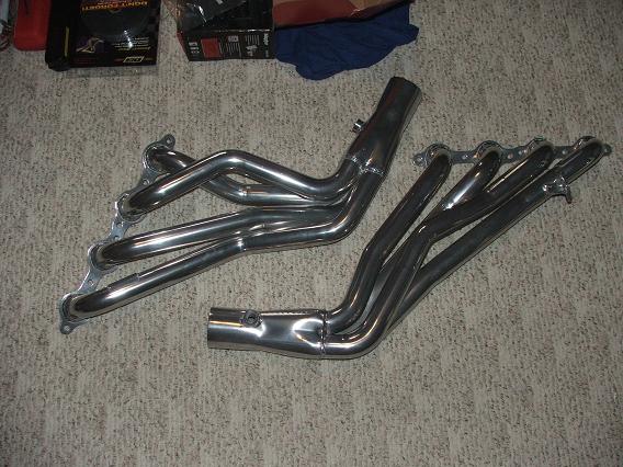

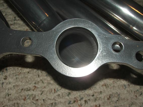

and about the ceramic coating, they're coated outside real nice and inside the flange/collectors. I took a knife to the end of the collector to gauge the thickness and it's about 1/16" thick ceramic coat. Thick enough for me. During the process of coating any tubular product, full coverage through the length of primaries is pretty difficult unless it's dipped into a chemical, then you can get full coverage easily.

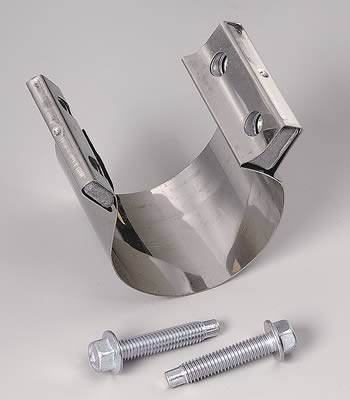

i didn't use any weld on flanges. The best deal is to use an accuseal type clamp that's a stainless steel band wrap around band clamp. I got the dynomax ones from summit that have 2 bolts for a better seal. When you weld onto the headers the ceramic coating can start to chip away.
the ORY comes with regular 2 bolt clamps which are okay for clamping mufflers and what not, but if you over tighten them they can crimp the tubing/pipe, that's why most everyone uses a clamp like the attachment or a v-band. personally I think v-bands are nice, but not really worth it unless i had a turbo setup or something
On my set up I won't be using a ORY, the 2500HD has seperate 3 inch pipe from each side, so no slip fit for me. I guess I could just butt the three inch pipe to the collector and then use a clamp and see how it will work. If that doesn't work then welding on a 3 bolt flage is my next option I guess.
