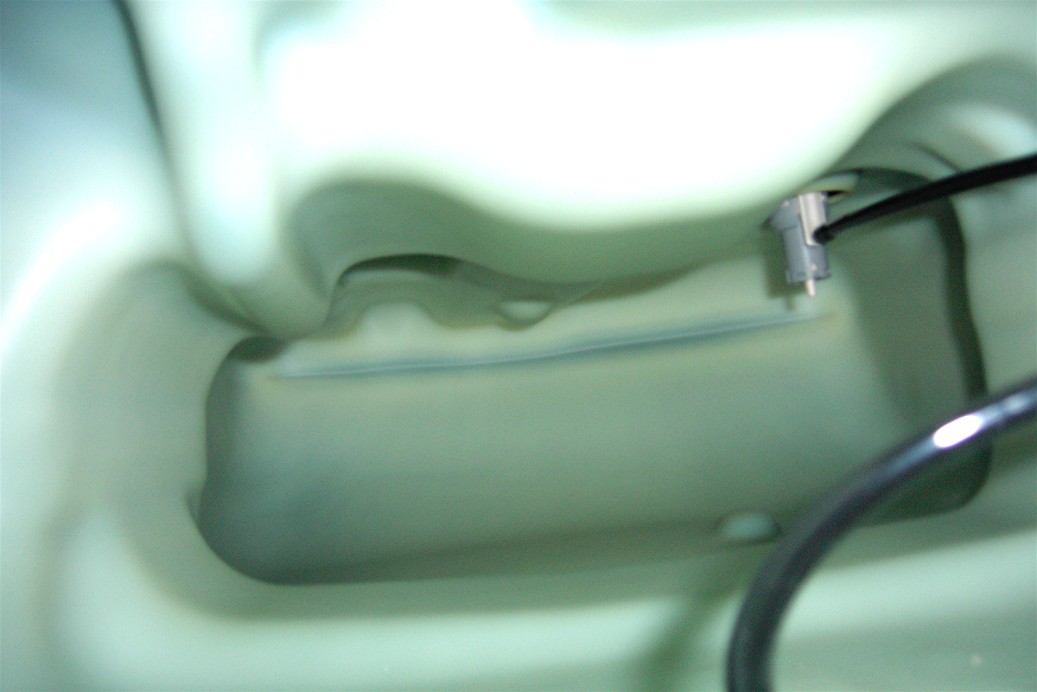

Originally Posted by BigKID
I definately NEED a pump! I can't spray the truck till I get one. I just have to decide on which way I want to do it. Depending on how the baffeling is in the truck tanks, I think I like the idea of a tank feed better. I am also going to look at my spare bucket assembly again tonight to figure out a few things.
All you guys that have changed your pumps, did you notice how well the tank was or was not baffeled while you were changing it?
Plastic tank=no baffles. That's the primary function of the bucket(to keep the pump submerged in fuel no matter what the tank fuel level is). Here's mine.
