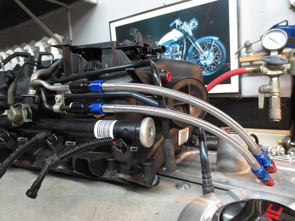

Hey guys I read through the thread and didnt get a solid answer to how to make the fuel system work I'm trying to go the minimalist route in my swap 2003 scsb with a 4.3 (runs good just so damn gutless) to a 03 5.3 (purchased a crashed suburban) . The 4.3 is returnless and the 5.3 is a return system any ideas would be greatly appreciated.
Old Aug 5, 2019 | 11:46 AM
  #329
RedXray's Avatar
100% Redneck
Joined: Mar 2005
Posts: 2,098
Likes: 1,344
From: MAGA COUNTRY

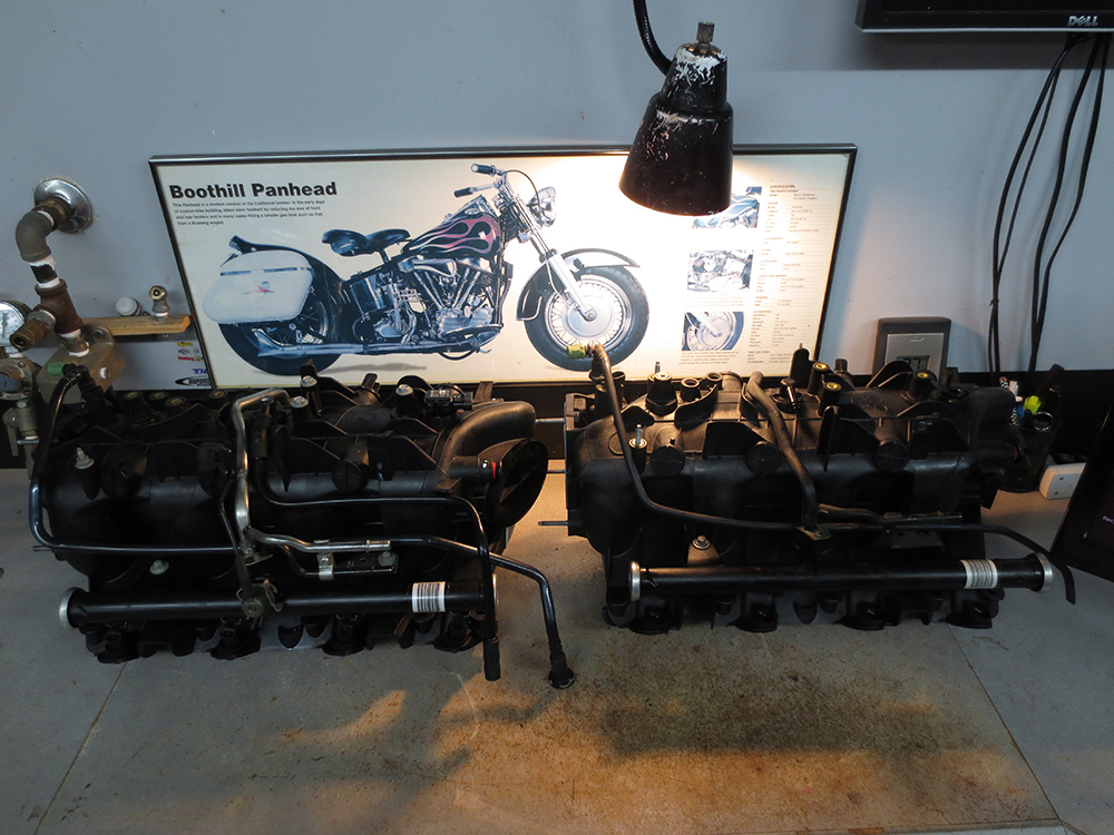

You'll need a non return fuel rail (drivers side) and the AN fittings and braided line for the supply only, that are posted in this thread.
You'll need the larger of the two lines (top).
You can see I chose to use "quick disconnect" fittings on the fuel lines
so I did not need to cut the hard lines like the original post in this thread.
If you look closely you can see the return type fuel rail on the left (two fuel lines) and the non return rail on the right with a single supply line. The non return fuel rail doesn't have the fuel regulator on the rail. The fuel regulator is on the fuel pump on your system... so no worries about the regulator.
