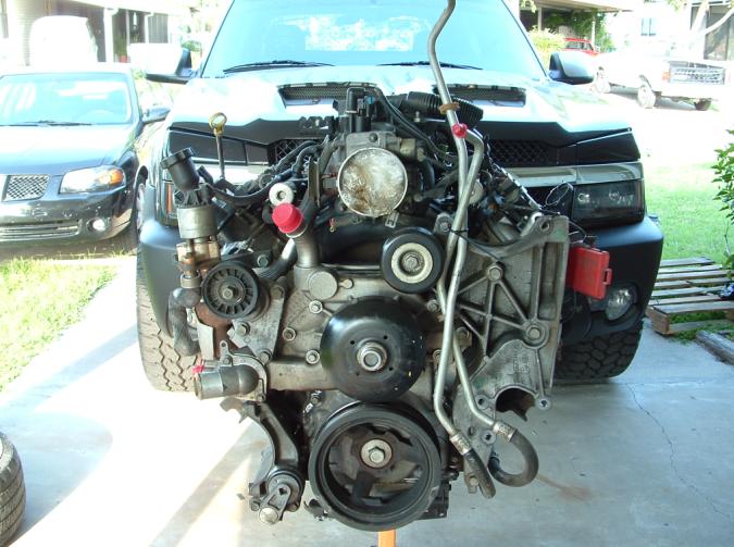

Well, here is the front of the motor... I can see a problem already with the upper right most pulley...
But, this means the F.A.S.T. will also have the same problem... Any one got any ideas or pictures of how to get around this problem?
https://www.performancetrucks.net/fo...chmentid=38999
Do a search for LS1 Intake Swap....Kano had an EXCELLENT write-up on this a few months ago. The pulley has to be moved using a bracket that Speartech makes (I've got one....it's a NICE piece)

Found it... https://www.performancetrucks.net/fo...7&page=1&pp=10
See, i think that the car intake will work great for me since i have Forced induction... It's all about smoother air flow, more air flow and getting it all in there to each cylinder...
