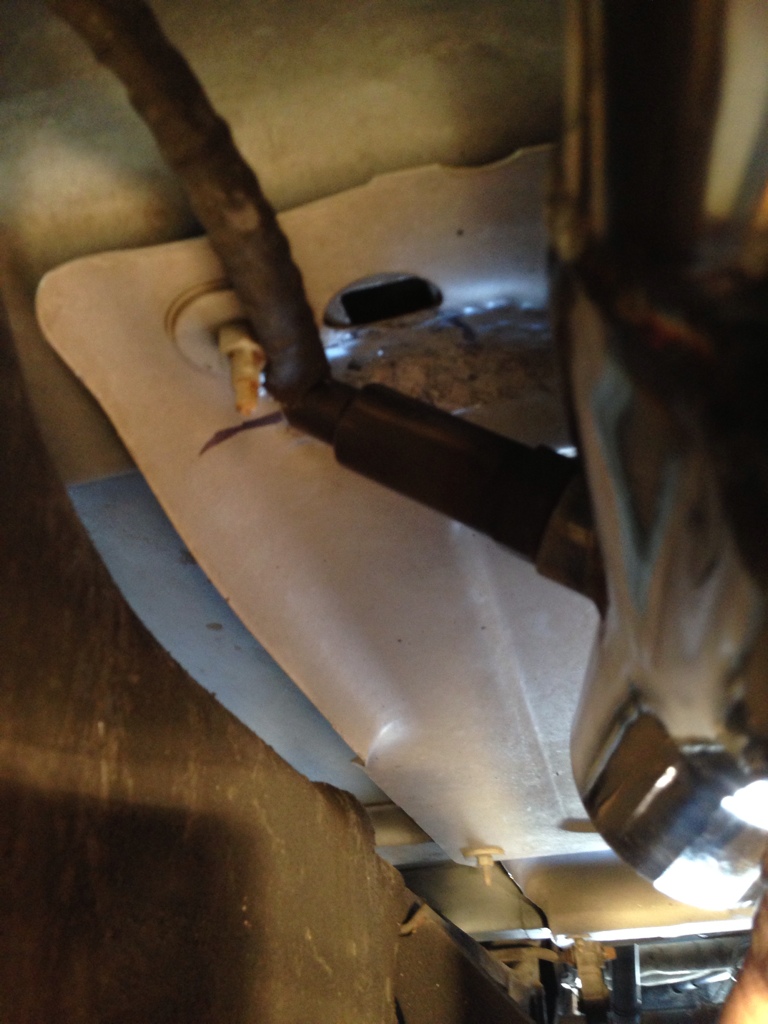

O2 sensor hits floor pan with long tube install! HELP!
Has anyone ran into this?

Is your transmission installed??

Yea it's installed

Then I'd probably remove that heat shield and cut off that stud. Should be okay then. You're not running cats so the shield isn't needed.

What brand headers are those?

Texas speed and its not hitting the stud it is hitting the floor pan

I have the same problem. Took the heat shield off and there's a part of floorpan in way. I have Texas speed headers also.

Cheap headers = BFH.
What does Texas Speed say about it?

If you dent just below the o2 bung it should angle it down just a hair... its worth a shot.
