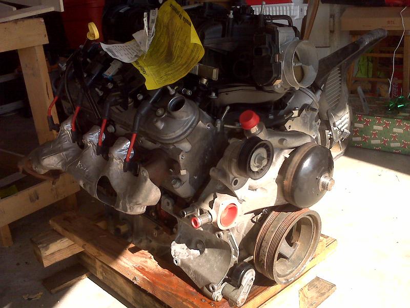

Default Picture of the engine
If everything goes as planned, this is the ly6 I am buying thursday. It has 18k Miles.
