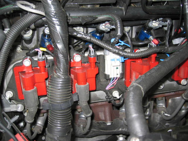

You should be alright to a 150 shot with colder plugs. The ECM will handle the timing retard but you are on the upper limits of the stock fuel supply. A 125 pill is safely in the ballpark. The attachment shows my setup, a NOS Nozle direct injection system. Its a pain to change jets (16x) but it does have the advantage of getting the same mixture to each cylinder.
Good luck, let us know how you get on...
How hard was your kit to install? When you pop your hood does it look like you just have different injectors. I want to be "sneaky" LOL. Thanks for the Help Bro.
