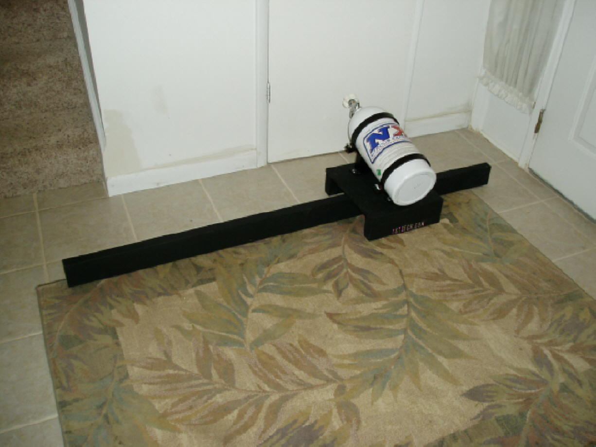

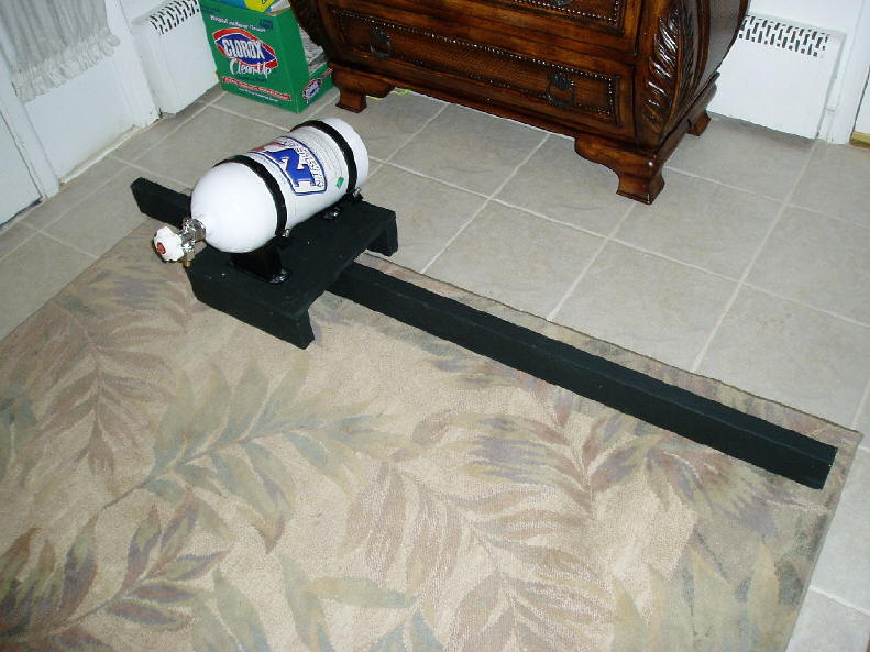

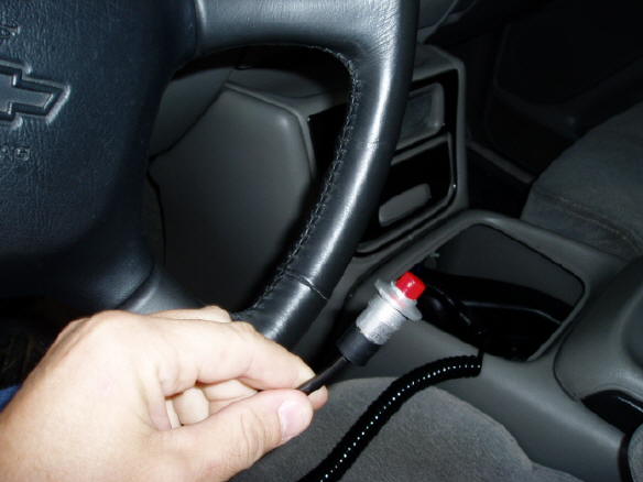

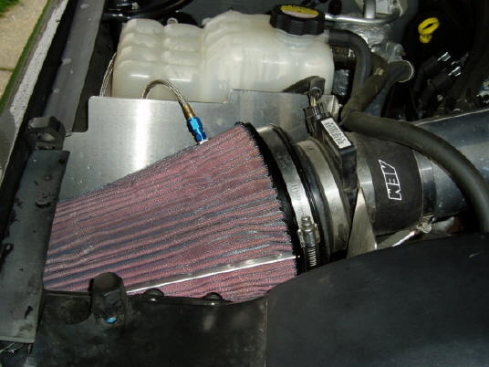

Here are the pics I took of the dry kit. I kinda threw it together. The bottle is a Nitrous Express, the solenoid is a Compucar, the nozzle and mount are both made by NOS, as are the jets and braided lines. I use a Hurst coil corded button for the activation switch, and have a toggle switch mounted under the steering wheel at the bottom of the dash to arm the system. Pics aren't that great, but you get the jest of it.
Attached Thumbnails Nitrous Install Pics-bottlemount.jpg   Nitrous Install Pics-bottlemount2.jpg   Nitrous Install Pics-button.jpg   Nitrous Install Pics-button2.jpg   Nitrous Install Pics-filternozzle.jpg

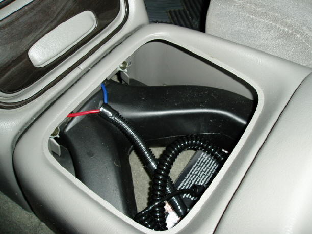

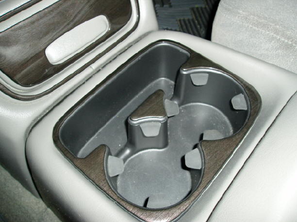

....and here are the one's showing where I stash the button and cord when not in use and the other pics I took.
Attached Thumbnails Nitrous Install Pics-cupholder.jpg   Nitrous Install Pics-cupholder2.jpg   Nitrous Install Pics-cupholderout.jpg   Nitrous Install Pics-mount1.jpg   Nitrous Install Pics-solenoid.jpg

Where did you put the bottle, and what is it resting on in those pics?

I have never seen the NOS nozzles put into the airfilter before. What does that do?? Is that a better way of running a dry kit??? Just thought it was unusual. Looks nice bro.

I plan on making mine kinda covert like that, arming button and bottle opener under the dash and i was debating on where to put the push button til i saw yours... where did you get the coiled wire that goes to the push button?

Yeah, my best was 14.57 without the nitrous, so I'm kinda hoping for 13's with the spray. As for the corded button, I got that from Jeg's (www.jegs.com ) mailorder. It's made by Hurst and its says it can be used for line-lock, nitrous, etc. My brother-n-law uses one mounted thru the hole in his Grant steering wheel to release his trans brake. Its a nice button, but pricey...$41.95. I'm gonna look now to see if I have any other pictures of the cluster. It's a silver Escalade cluster which I installed right after the converter so that I could monitor trans temps. The bottle "thingy" I made from 2x4's and a small piece of thin board. It slides right into the slots in my bed and is pretty secure, that way I didn't have to drill holes in my bed. I ran the line thru the hole that is already in the bed in line with the stake pocket and then down under the truck thru the stake pocket. I just didn't want to drill holes in the bed. Thanks guys!

Here is another picture of it in the bed....and a picture of the cluster that someone asked for.
Attached Thumbnails Nitrous Install Pics-inbed.jpg   Nitrous Install Pics-cluster.jpg

Nice job on the bottle install! I thought about that a while back.....Hey Chingon....I think that is what you should do. Easy in and out.
