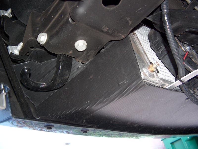

If you are talking about upgrading your heat exchanger (the intercooler is the part buried in the intake manifold, just underneath the blower), then yes, several folks have done so.
Here is what I did on my SS, which has the advantage of a lower grill opening that is just crying out for something to be added
Electric fans keep the air flowing while at the stop sign. Plastic ducting keeps the air flowing through the heat exchanger while driving.
