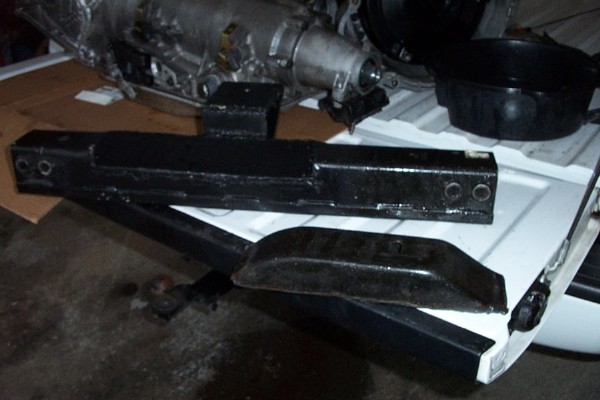

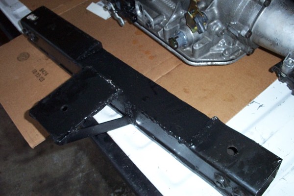

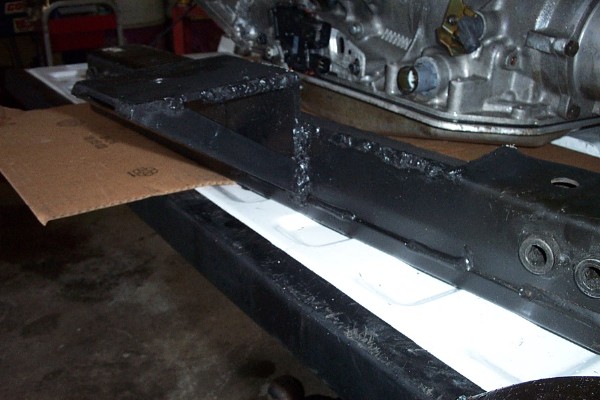

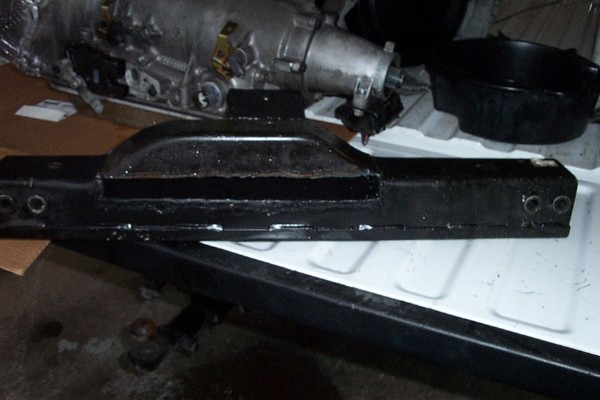

Old Mar 29, 2004 | 09:20 PM
L-EATER's Avatar
11 Second Truck Club
Joined: Jan 2002
Posts: 1,412
From: Missouri
ok here are some pics of mine. had to cut the hump out of it for pan claearance and when i boxed it back i angled the new metal downward and towards the front so the 4l80 pan can come off without removing the crossmember.
