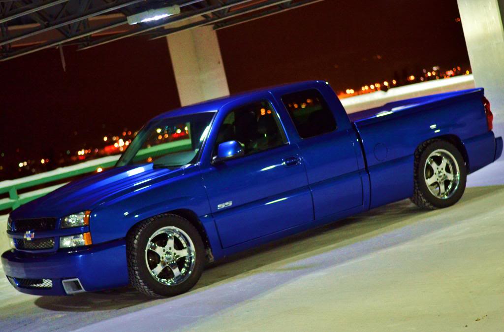

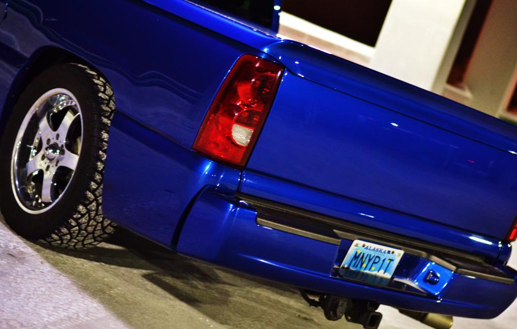

Had some warm weather this weekend and decided to take a few pictures. Thought id share...
