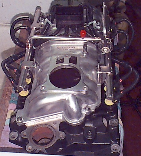

JamesB,how and what did you do and use there man?????I want to know please????
Old Jul 25, 2005 | 02:13 AM
James B.'s Avatar
Joined: Mar 2003
Posts: 1,985
From: 33.91° -117.48°
That is a very carefully tinkered-with L31 Marine EFI intake manifold. It's not installed yet but it will be this year. It has real injectors, will have functional EGR, will connect to the stock fuel lines, and it will literally plug in and bolt down in place of the stock CPI manifold.
This is no minor afternoon project. A great deal of time and money has been spent by many people collectively to bring this to reality. Our efforts are chronicled on the Pacific Performance Engineering Forum.
Here's a link to it: http://www.pacificp.com/forum/viewtopic.php?t=317

Wow, that is very impressive James! Are you going to run an aftermarket Engine Management or have you adapted to the stock PCM? I found that Tunercat sells tuning software for these trucks at a very reasonable price, so I am going to pick that up soon.

Great job on the intake Looks very impressive, someone may actually be able to make decent power on one of those motors

I have 1 installed, it works great.
Cmon James get it installed. No more 19 lb/hr injectors, there is 1 on ebay for sale as we speak.
http://cgi.ebay.com/ebaymotors/ws/eB...tem=8007462179
Here is the conversion
