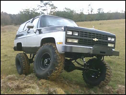

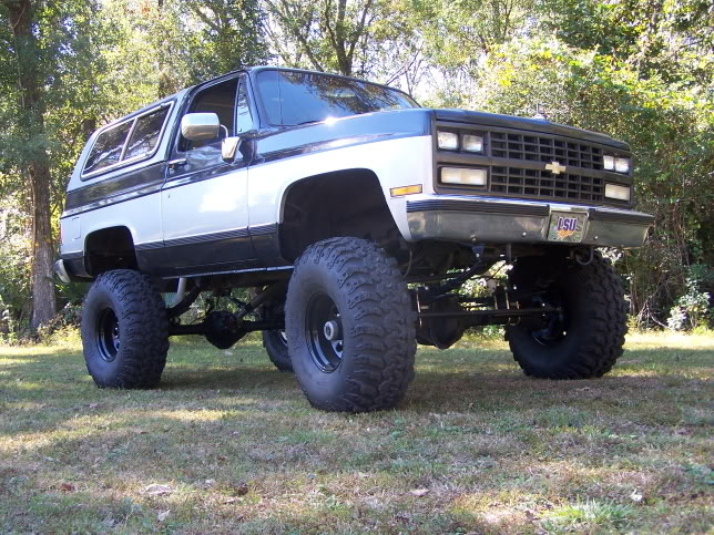

Big, you got any shot of the K5 on 40's... sounds cool..
Old May 6, 2008 | 08:19 PM
BigCountryx's Avatar
12 Second Truck Club
Joined: Feb 2006
Posts: 1,457
From: Baton Rouge
a couple
