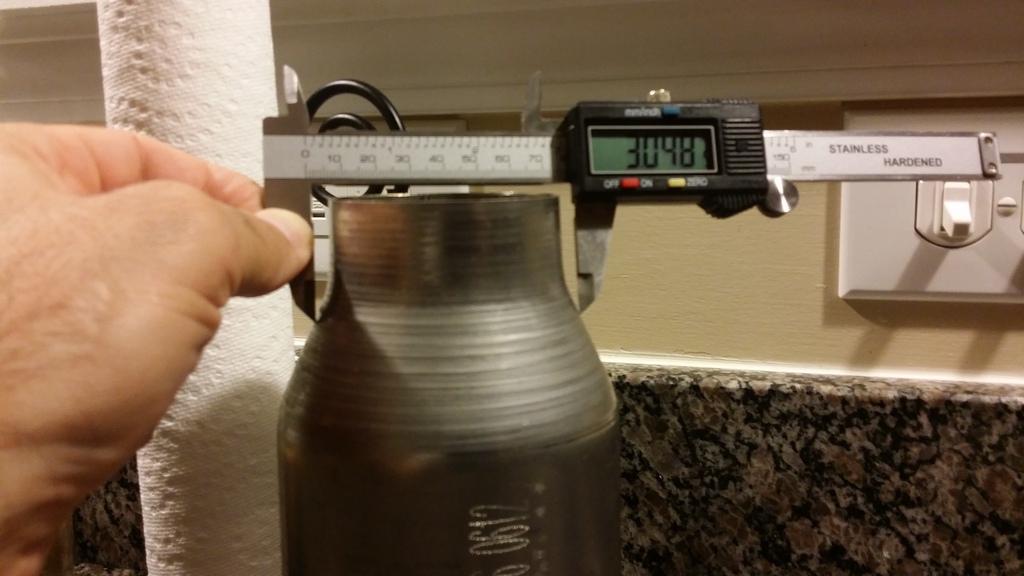

This is my plan for cats and my LTs.
Magnaflow 59956 high flow spun cats are 2.5" inlet/outlet and are 8" long. I'm going to cut them down 1.5" on each end, that will shorten them by 3" inches for a total length of 5" and give me the 3" inlet/outlet diameter needed for my 3" exit and exhaust.
Not the best pic but you can see how much will be removed to give me the 3" inlet/outlet

Yes, they are 8" overall. After being cut down, they'll be 5" overall.
You should be able to get 3" V-bands for them.
Well, this is the beginning stage as I am just starting to put this on paper while I get my block prepped and built.
I will more than likely weld them on to the y-pipe and v-band to the header.
You could always do what I'm doing but only cut one side down to get you the 3" inlet and 2.5" outlet.

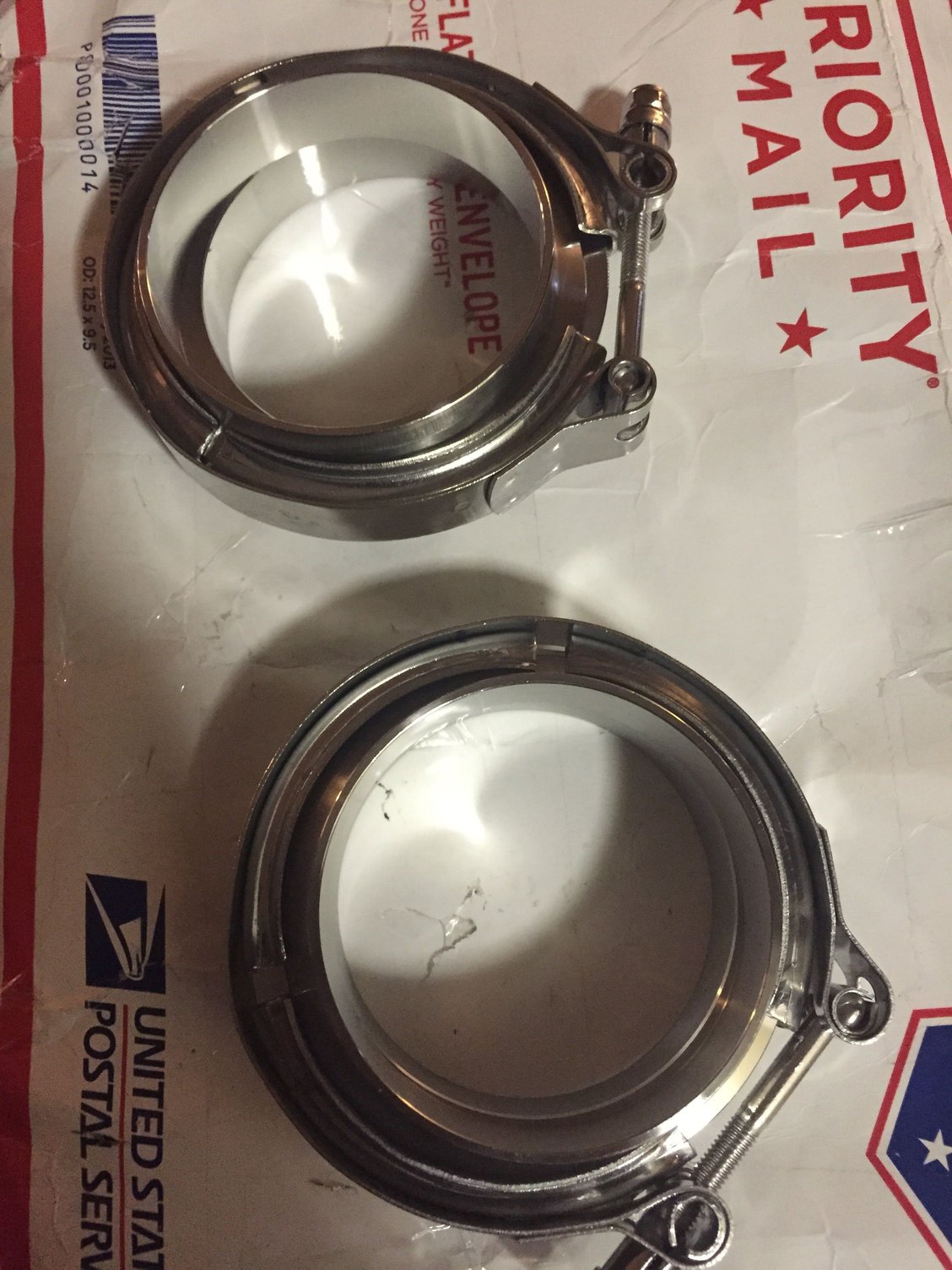

Unless im missing something the vbands need to have a flat surface to mate to, as i understand it one side would be extended slightlybthrough the band the other would be recessed into it the same distance, so the pipes are end to end inside the band!!!

That's correct.
They also make machined male and female v-bands.
V-Band Flange & Clamp Kit
