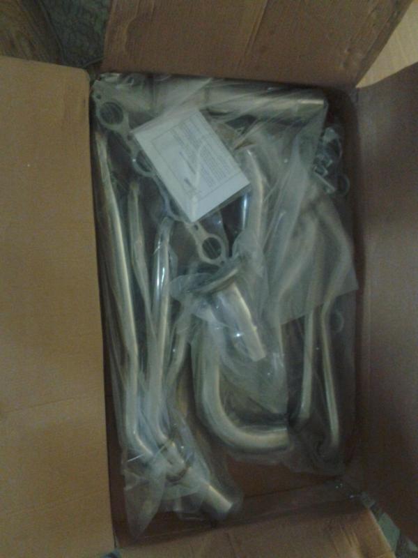

I received them this past Friday (10/11) after waiting about a week or so. They came nicely packaged in a large box that said "XS Power". Inside was a lot of packing material and another smaller box with the headers and y-pipe. Each was individually bagged as well as the clamps, gaskets, and wiring to lengthen the O2 sensors.

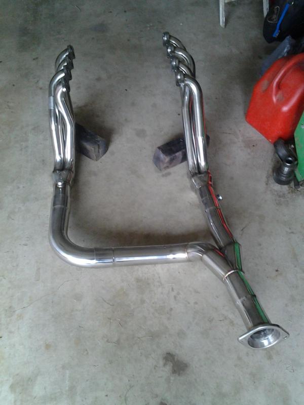

I proceeded to lay them out to see what they would look like. The quality of these is awesome. Super nice TIG welds and very highly polished.

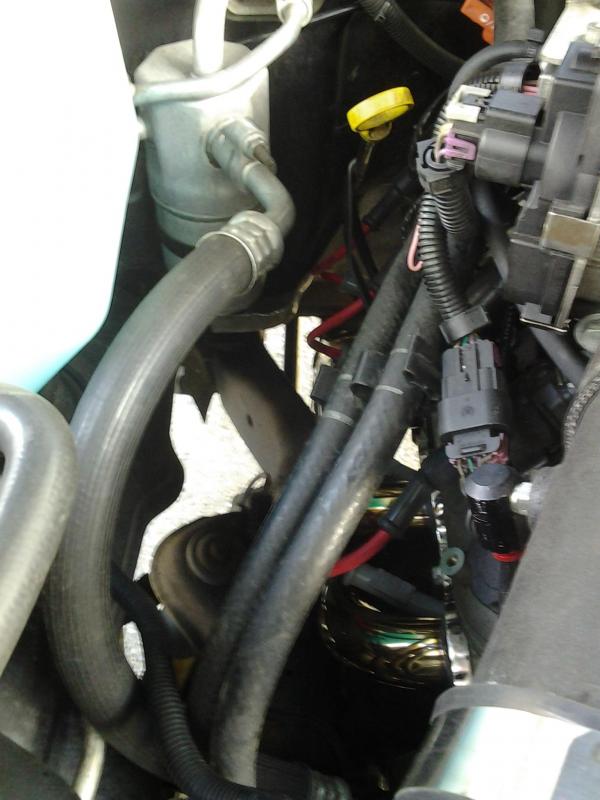

On to the passenger side: Like I said above, I already have headers so I have been through the ordeal or removing the factory exhaust manifolds and y-pipe. Once the passenger side Stainless Works header was removed from the top, the LPP header slid right in from the bottom. All that I needed to remove was the dip stick and plug wires. Spark plugs remained in the head. The fit was impressive. It touched nothing on the frame or the engine.

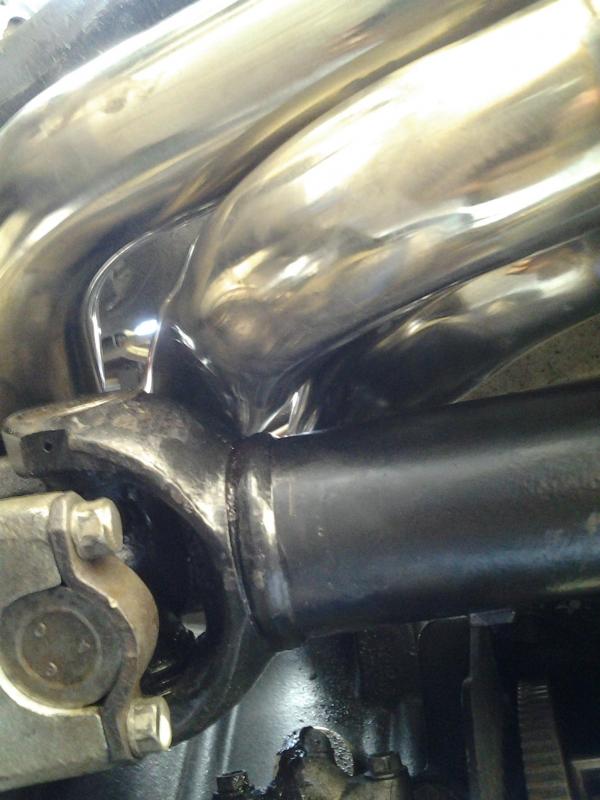

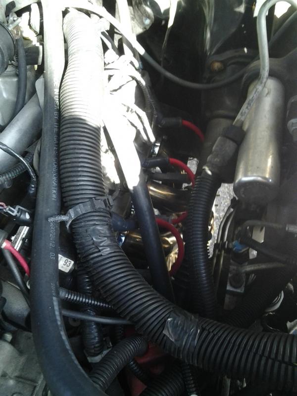

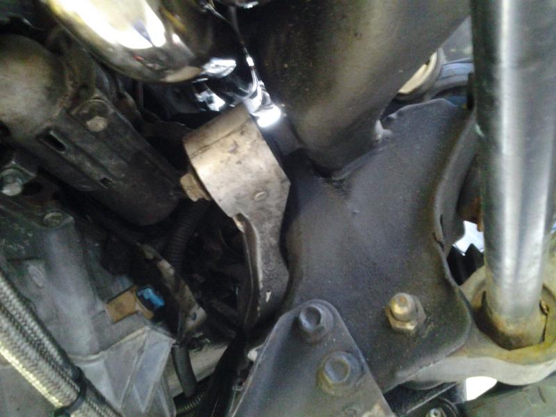

On to the driver's side: This was the fun side! Per the LPP website, these headers will fit 99-06 4.8 & 5.3, 2WD and 4WD. I will say this...these do not fit 4WD without some handy work. I have read numerous posts on various websites about the installation of these so I knew what I was in for. I had to remove the upper steering shaft from the lower, plugs and wires as well as lowered the front drive shaft from the front axle. This allowed me to install from the bottom and temporarily bolted up the header to the head using (2) bolts. This allowed me to mark where the primary tubes (3) were being hit by the front driveshaft, yoke and bolts. I removed and then dented with a hammer. I had to do this twice to get it right.

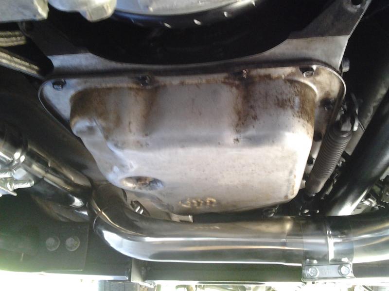

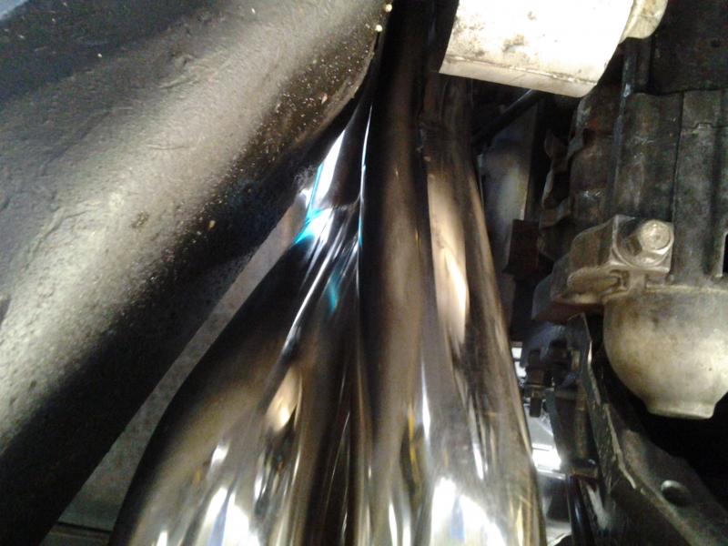

Once all buttoned up on the topside, I proceeded to the y-pipe. The y-pipe is nice mandrel bent pipe and it was a nice but tight fit. This was more than likely due to my 4L80 swap. I had to dent the pipe going under the transmission pan. I did this by using a block of wood and some good hammer blows. The dent is very similar to the Kooks 4th Gen F-Body y-pipe.

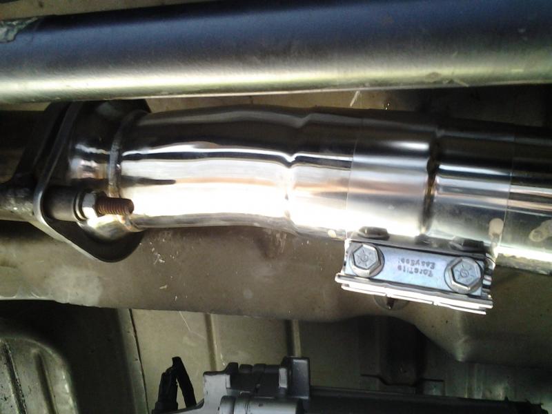

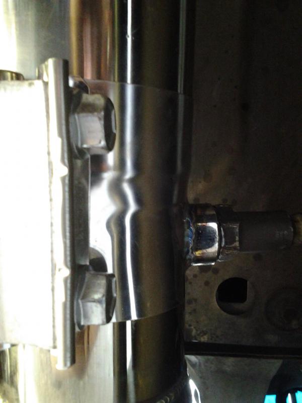

The driver's side collector to y-pipe connection was simple and straight forward using a 3" SS Band Clamp. The passenger's side O2 sensor bung is right at the edge of the y-pipe connection. I had to notch the band clamp in order for it to slide around the bung. If using the included clamps, this would not have had to be performed.
