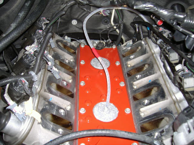

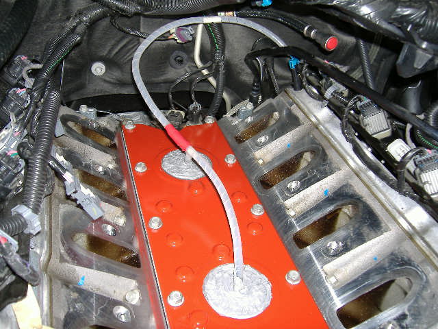

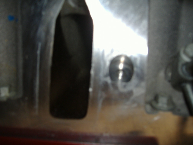

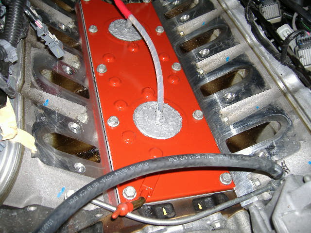

Note the oil left in the intake ports from the old PCV system...

Ok, I'll ask. What exactly did you do? Did you switch over to the LS6 pvc system?
Yea, it's an LS6 cover, but I took the foam pads out and added a little more protection and insulation to the knocksensor circuits. I couldn't believe how much oil was getting in there. Maybe taking those pads out will help releive some of the heat getting trapped under there.
