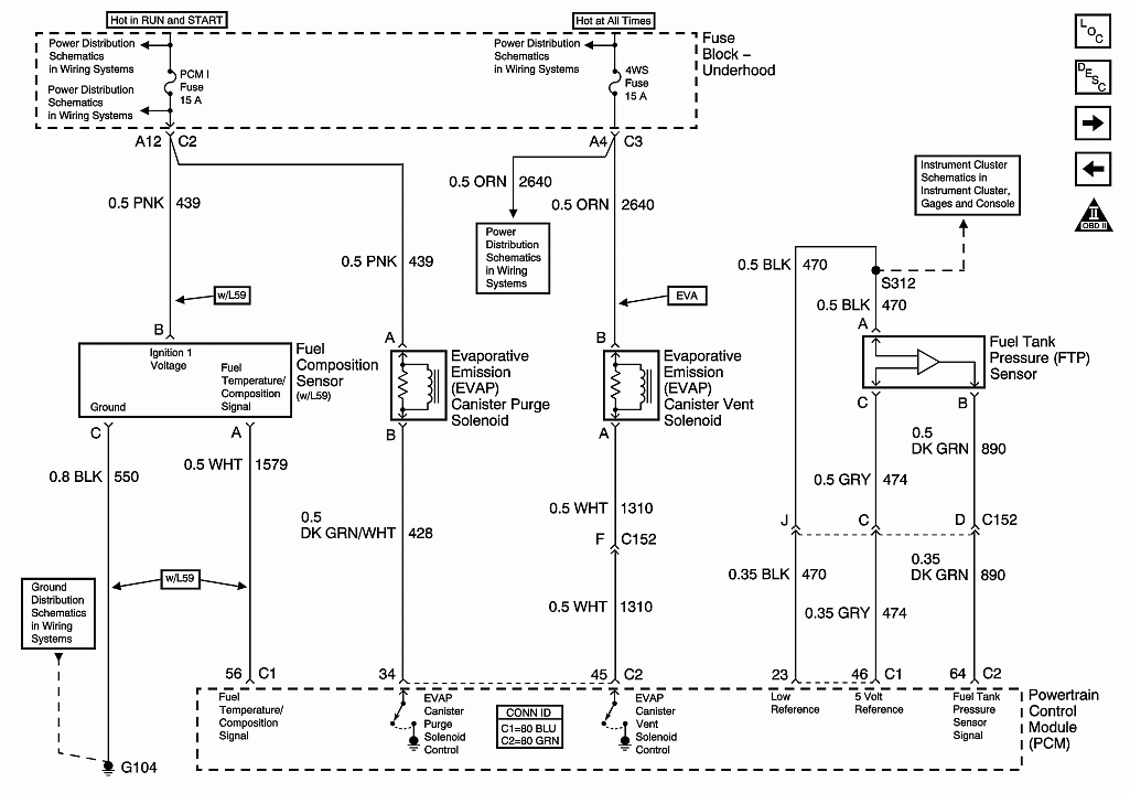

As an update - I tried making the programming work for the 06 - swapped pedals and TAC modules in to solve my ETC issues - still only 66% throttle. Dug into it some more and found the winring is what is different as well - I'm not going through that to make it work. gonna get a friend at the local scrap yard to help me out - should be able to get a flex sensor and the lines and connector end for not too much cash so i can drop it right in the truck - no fuel line splices needed!

Do you know how to hook that sensor into the PCM? i researched this awhile back.

Yeah the wiring diagram is this - just running the wires to three places nothing major. and yeah i found that thread before...
