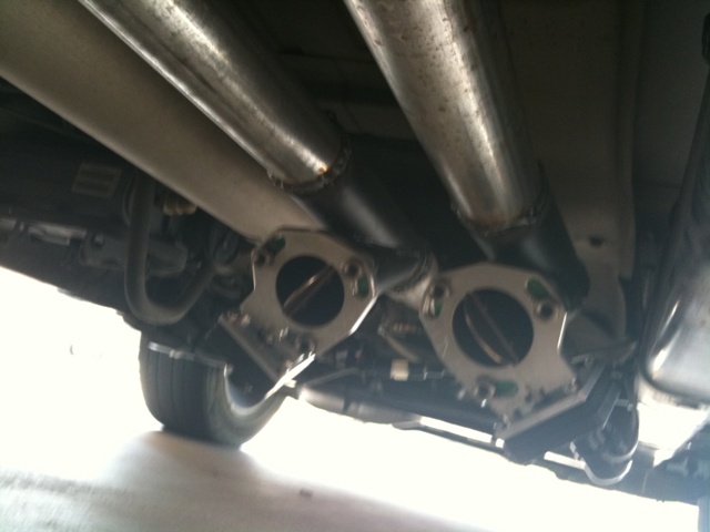

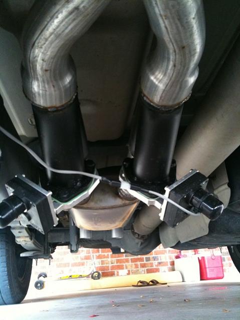

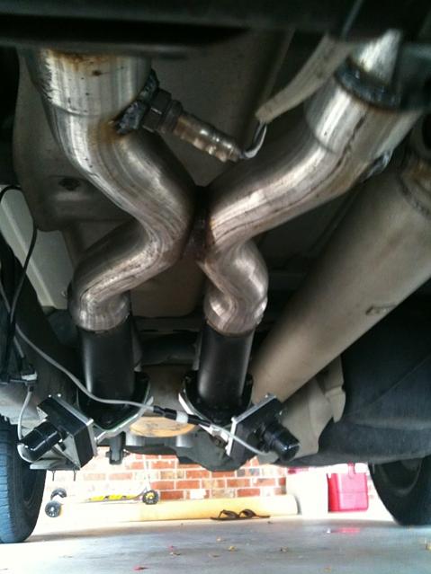

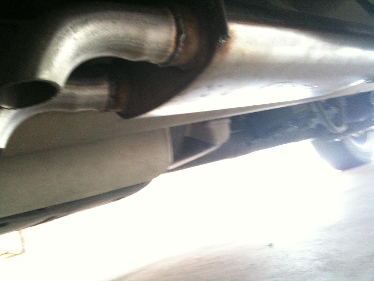

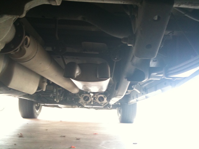

heres somes pics if youre interested:
Attached Thumbnails my DMH cut-out, well, cut out...-true-duals-004.jpg   my DMH cut-out, well, cut out...-true-duals-005.jpg   my DMH cut-out, well, cut out...-true-duals-007.jpg   my DMH cut-out, well, cut out...-true-duals-010.jpg   my DMH cut-out, well, cut out...-true-duals-011.jpg

It will be covered, make sure there is nothing in the way of the valve, I would unbolt it off the truck and take a look.
Tell Dave that they were originally purchased from me (Im a Dealer)
They were purchased by David on May 22, 2009
DMH- 937-444-0900
Make sure your wiring harness has no way of touching the exhaust pipe.
