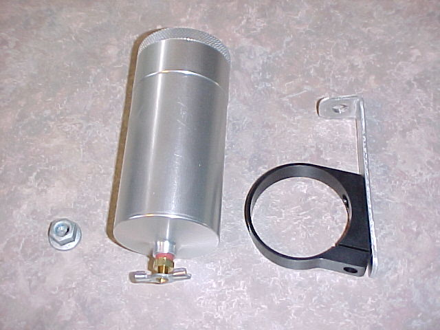

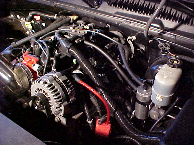

I thought I would try A little differant location. It seems to be out of the way and close to the intake valve cover etc..
Used a piece of flat bar aluminum. Used the Brake booster bolt to hold it on.
enjoy,
Great product, Sponsor--------
Attached Thumbnails My Catch can Pics-cc-bracket-1.jpg   My Catch can Pics-cc-bracket-3.jpg   My Catch can Pics-cc-bracket-5.jpg   My Catch can Pics-cc-bracket-6.jpg   My Catch can Pics-cc-bracket-4.jpg

Looks good

Pardon my stupidity but what does a catch can do?
Old Nov 19, 2004 | 02:34 PM
Joined: Sep 2002
Posts: 538
From: C.S. TX
I like it there. I may have to move mine there.
The catch can catches all of the oil/oil vapors that travel through your pcv sustem, and into your intake manifold. This helps keep sludge out of your intake, combustion chambers, and off of your spark plugs.

Looks good...

Looks like it belongs there, good job!

very nice man

Damn that thing is big. It could catch a whole QT. Mine is a small seperator and works pretty well.

Very Nice! Somebody's been thinking! Is that mount meant for the head? Mine's currently screwed to the fuse box. ~3000 miles and no oil....

No oil, I guess thats good. My can, which is mounted to the head, had a little over a table spoon of oil in it after ~400 miles.
