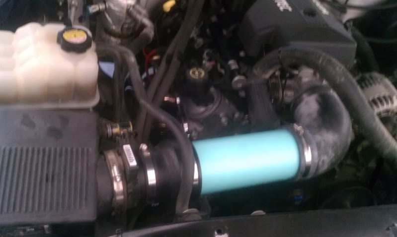

I just used some 4in drain pipe, a 900 degree elbow I got off the net 20$ and the transition for the MAF got it at lowes. It works good and cost me less than 50$. I wrapped the tube with header wrap to try to keep heat out.
